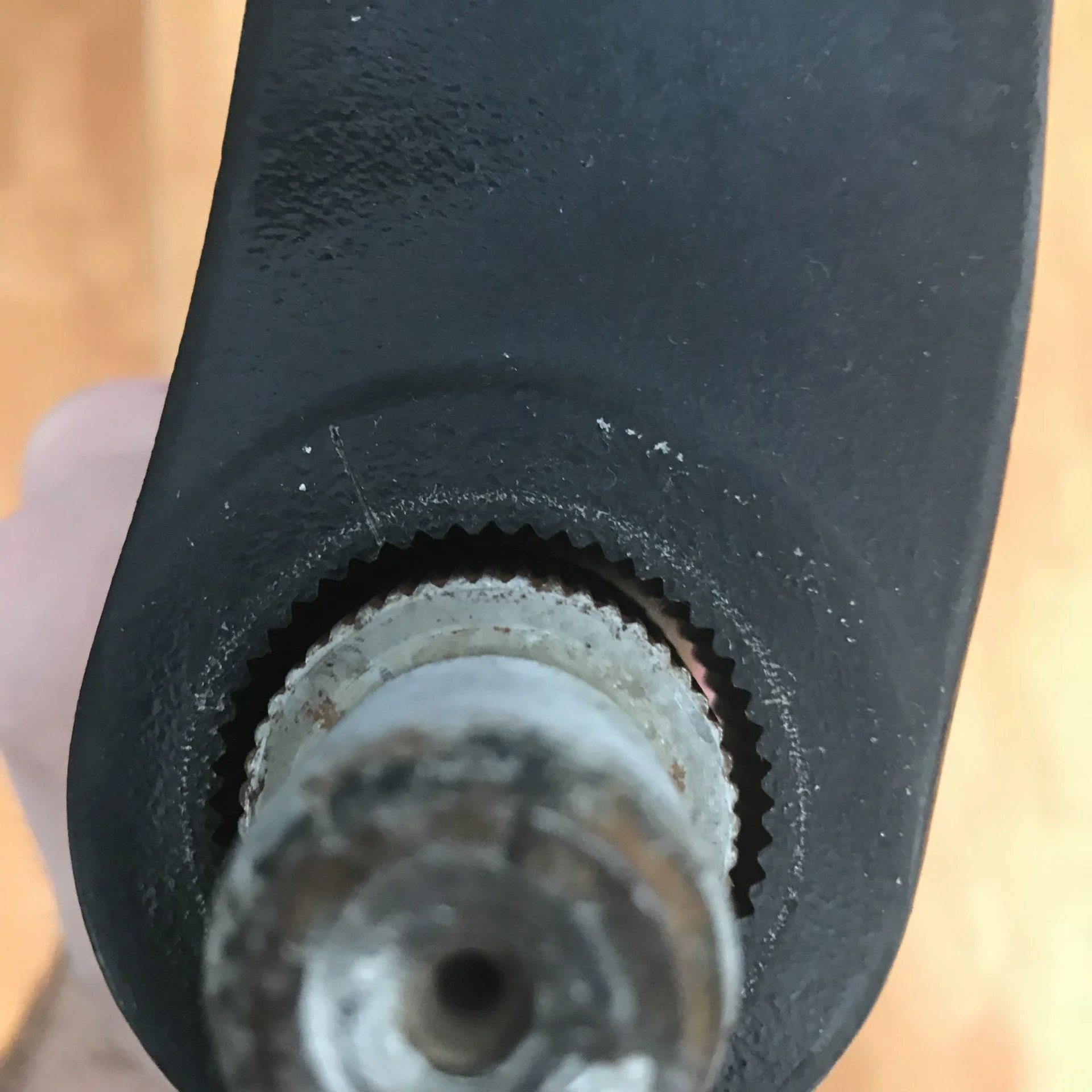

105 pitman arm and 80 sector shaft to show the difference in diameter.

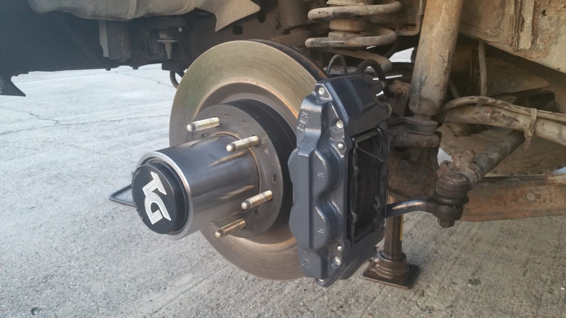

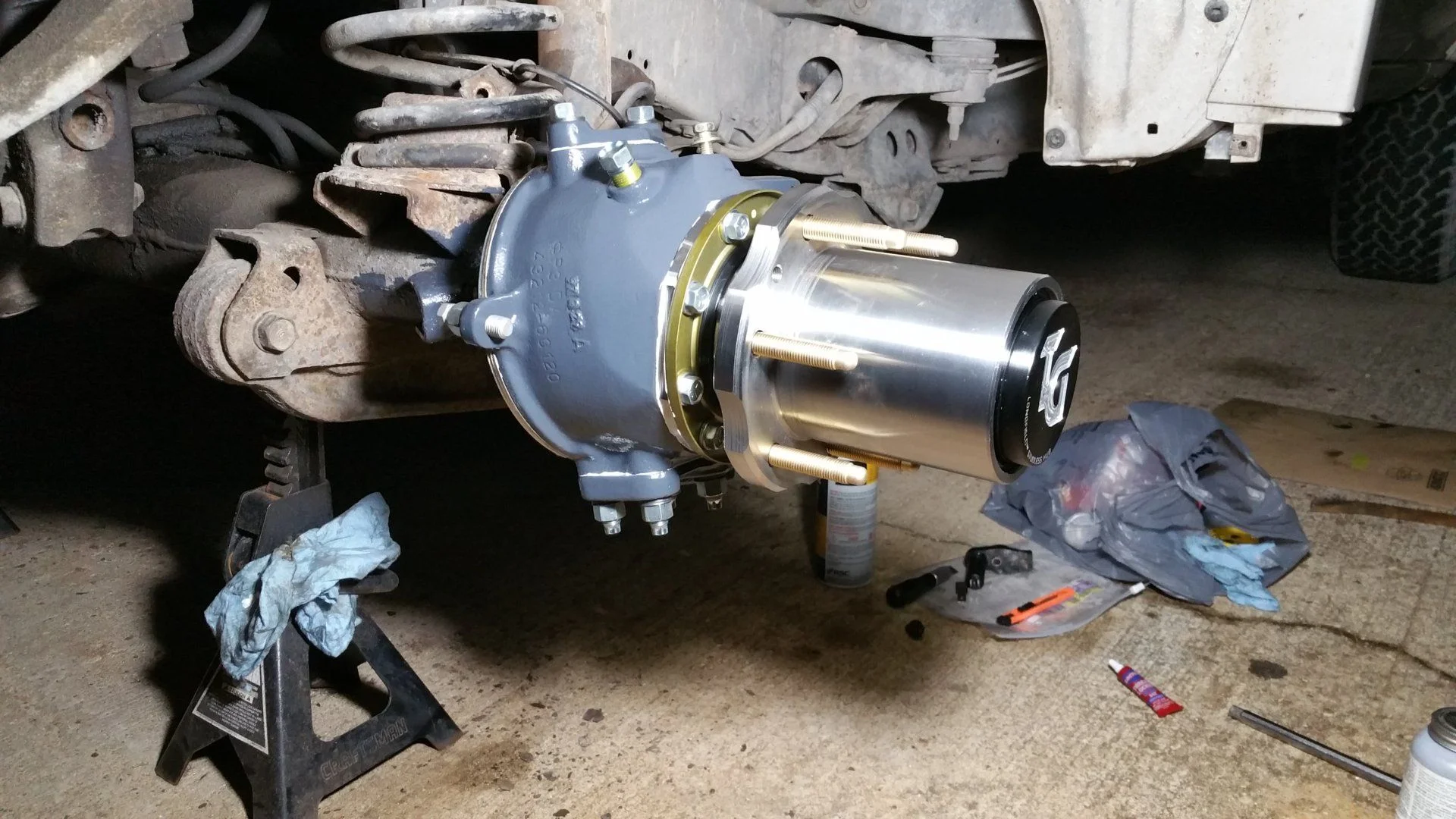

I just completed a rebuild of my driver's side steering knuckle, wheel hub, spindle and brake components - adapting the Longfield studless hubs, chromoly spindle and the 48mm 4-piston caliper with 338mm rotor from a 2015 4Runner. With careful planning and some minor machining work, everything bolted up very nicely! Only the driver's side has been completed, as a proof-of-concept allowing me to evaluate the installation and note any changes to be incorporated into "round 2" on the passenger side.
I'm trying to consolidate all of the information that I have, to do a write-up of the project. I'm a bit of a noob when it comes to posting write-ups, so this should be a fun intro!

Rebuilt 1997 Toyota steering knuckle.
Trail Gear spindle and studless hub.
2015 Toyota 4runner brakes.

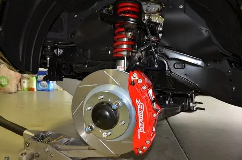

Of course that guy that makes this awesome discovery makes 4 posts then disappears. I've been curious about these studless hubs for years and could never figure out if they worked on the FJ80 or not. Anybody else have other insight as to what kind of machine work is required? This along with Nick's recent 5th gen 4Runner brake upgrade has me really interested.
in for more info. looking for caliper bolt length and whether wheel studs need to be swapped out with longer studs!
