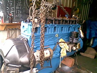

The first 2 pics are of the motor the 75 should have either the EFI or carb version but the 3 pic of blue motor is a 3f and prsume thats what you have the yellow rag in the side is where the dizzy is??

This is the 3F in my FJ73
