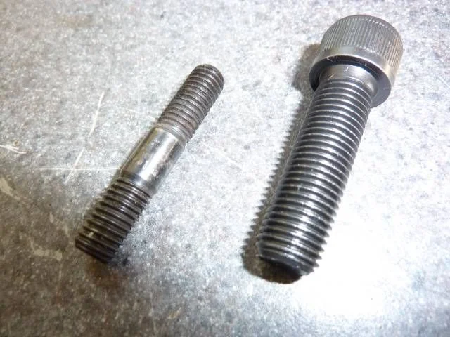

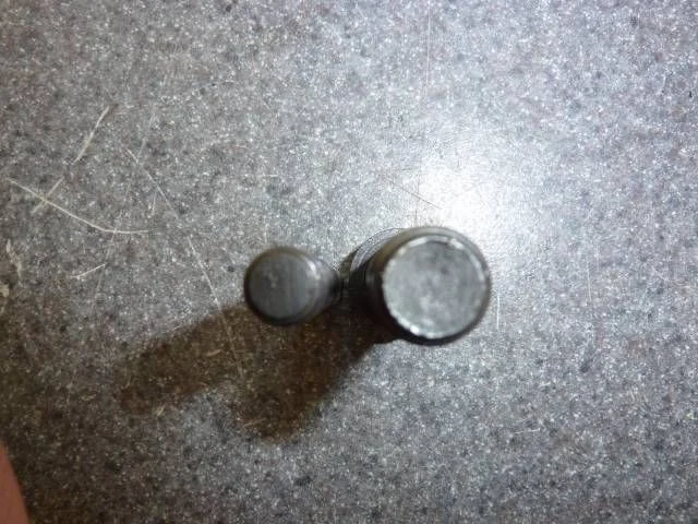

OK, so I posted the thread about breaking my ARP hub studs and dowells this week on the Rubicon....twice. Well that pissed me off and I decided to make it better with some fellow mudder suggestions.

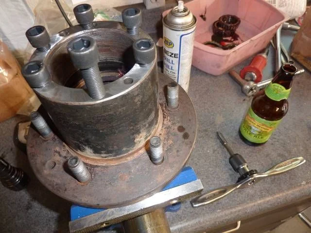

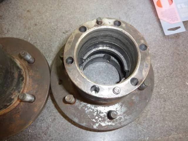

Went from 8mm studs to 7/16" x20tpi cap bolts. much bigger ande still plenty of meat on the hub.
next, drilled the stud holes in the hubs in 2 stages. 5/16" to get the threads out and then 3/8". btw, I would not recommend doing this without a drill press. the hole needs to be precise to be tapped well.
next, tapped the holes with a 7/16" x 20tpi tap. making sure the tap is very straight when started, and also take it in small chunks back and forth using cutting oil. if you take too much you risk chunking some of the threads. and a test fit reveals a nice snug fit without any play.

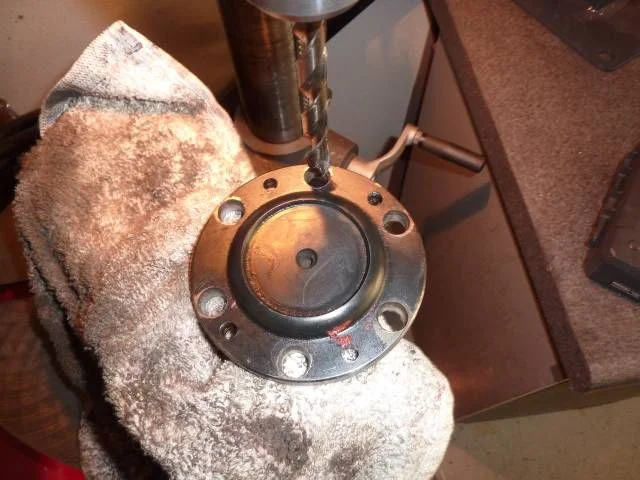

next, drilled the holes in the axle shaft out to 7/16". this leaves a small amount of taper at the top from the cones, but not much. I was a bit worried that without a cone there would be some play, but not the case. It is kid of a PITA to drill these on the press, but not too bad. also remembered to drill my spare set of axles in my tool drawer. (that coulda been lame with a busted axle on the trail and holes too small on the spare:hhmm:...)
now...I am not sure about the warranty with the polly's being drilled, but I doubt I woulkd break them there.

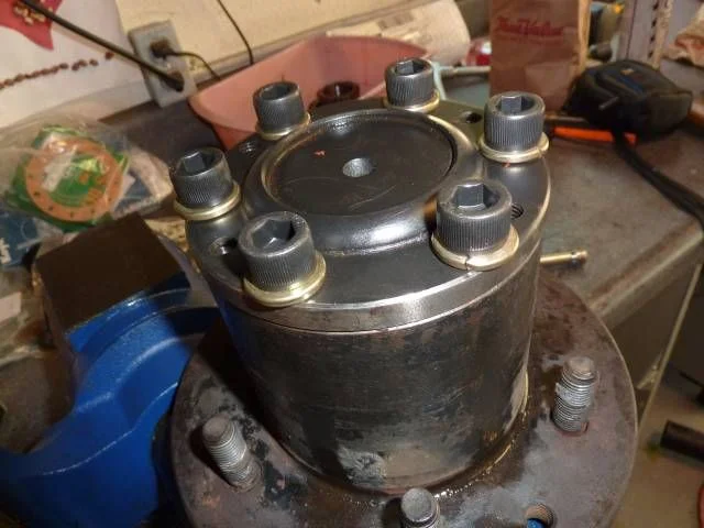

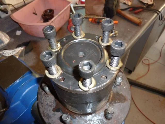

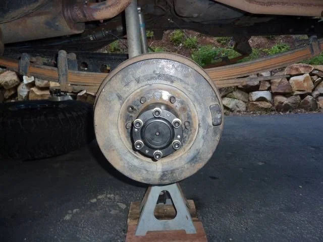

new bearings, and seals, slam it back together, set the wheel bearing preload, torqued the new cap bolts to 65 ft lbs. and there it is! :eek:
I used hardened split washers also and had to grind off the small edges that hung over the hub just a bit..
I will keep you updated as to how this works. It seems to me that it will be bomb proof....and now I probably made my pinion the weak link...lol
