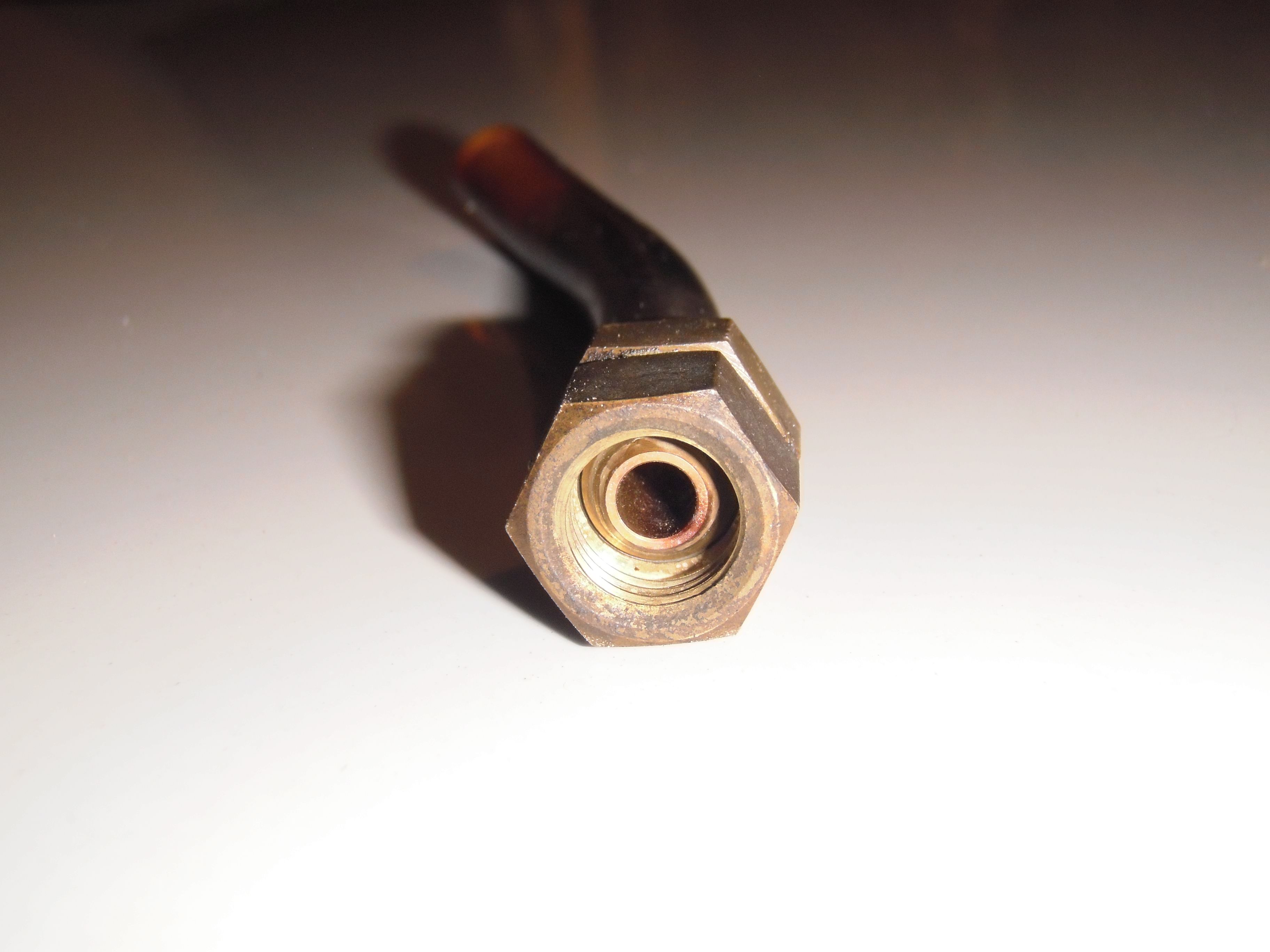

fitting looks liek this:

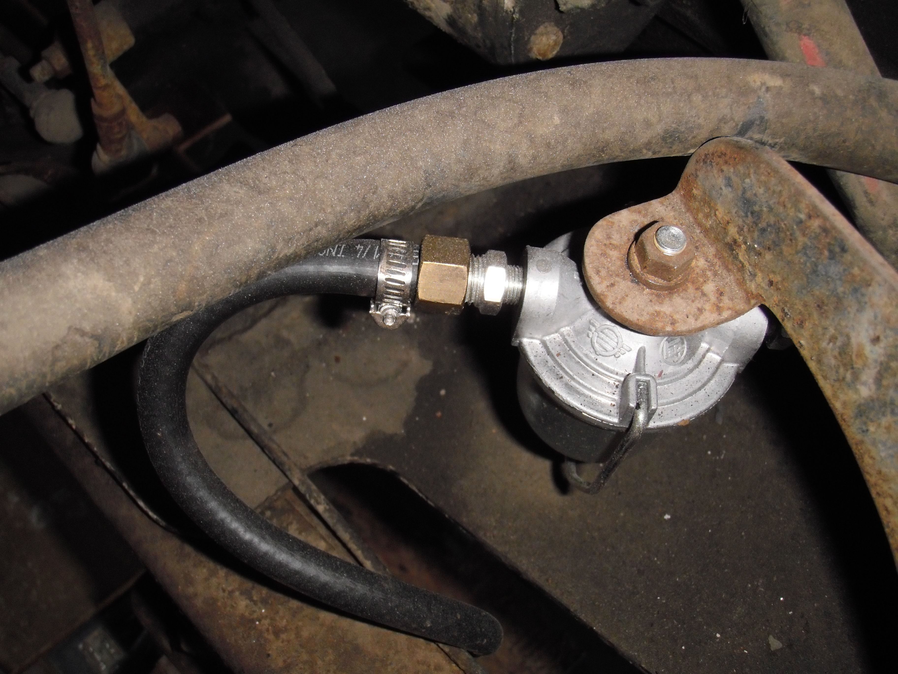

That was my pic. There is a compression fitting on the bottom nut. I had to heat my old lines up to get everything to melt apart. I couldn't find the compression fitting so I took the top nut and furrel and put them on new hose. I then clamped the new hose on with hose clamps from the hardware store. Works like a charm with no leaks and no gas smell.

This is how I did mine. May not be the official way but it works wells and doesn't look terrible.

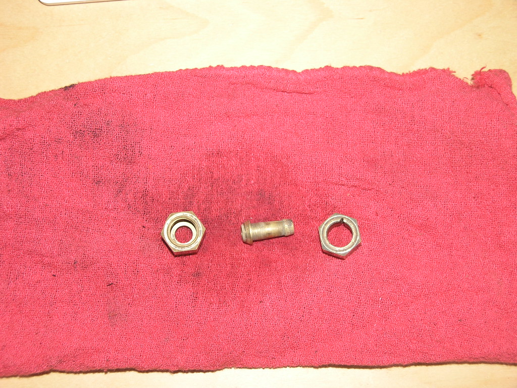

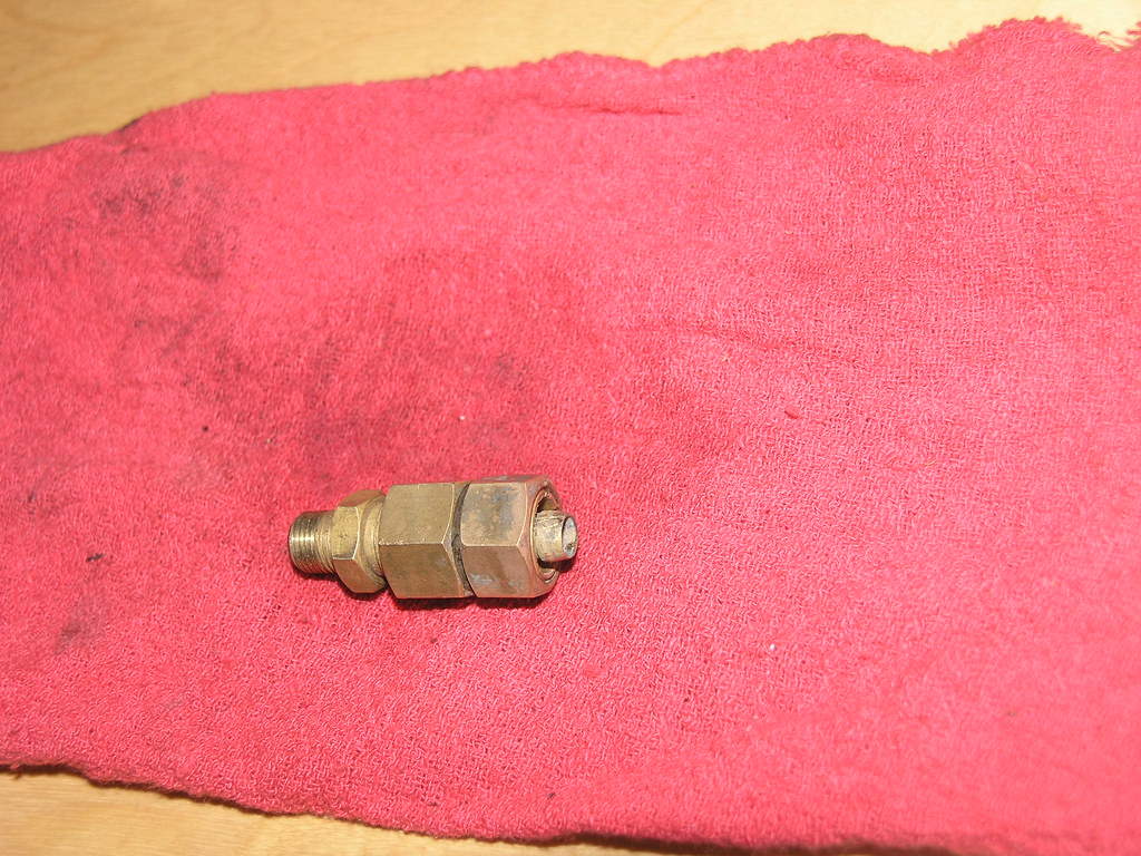

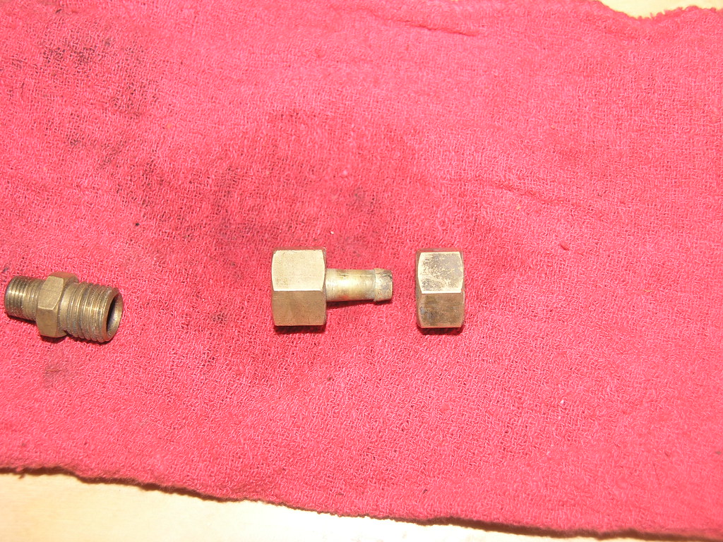

I pulled the conector apart and these are all the bits
Looks like the flange nipple bits go inside the retaining nut that connects to the tank or female thread nipple.
Then the lug/compression fitting is pressed onto the flanged nipple with the hosed and just pressed on untill it clears the flare.
Seems pretty simple, am i missing any bits?
Seems simple, photos:
popped in a brass fitting that will force the bit semi flush in the retain so i can press the hose and retaining nut on.

Looks like you've got all the pieces there. Yes I used the same setup from tank to filter and from filter to pump. I was under the impression that the compression fitting was pressed into the lower nut after the hose had been inserted. I didn't figure I'd get a strong hold by reusing it so I went with hose clamps cause I knew that would work.
