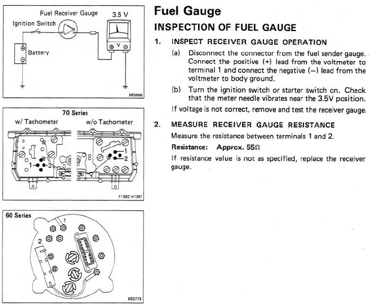

you can pull the instrument cluster and test the gauge. If the gauge checks out, I would check the gauge for voltage and check the wire between the gauge and the sending unit (yellow with red stripe) for continuity.

My sender seems to have appropriate resistance between the terminals (rear of truck, access panel pulled).
My gauge doesn't register any voltage from terminal 1 to body ground as shown above. ? When turned on, it just barely raises above E. Resistance is about 30 ohms, instead of 55.
Seems like it's the gauge?
