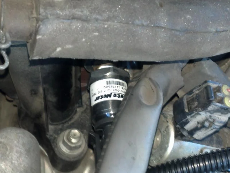

Based on recommendations I am looking toward the fuel pressure regulator. I would like to put a mechanical fuel pressure gauge connected in on the front banjo bolt, drivers side closest to radiator, on the fuel rail. This way I can observe actual fuel pressure in the rail under varying conditions.
Does anybody have the size specifications on this bolt? The fuel rail looks aluminum to me so I don't want to mess it up with the wrong bolt.

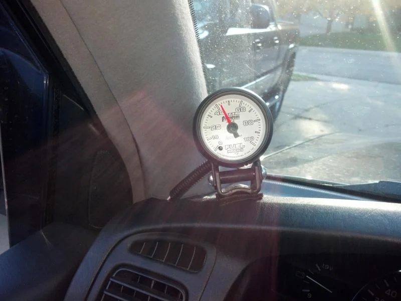

On this 2006 LX I have figured out how to put the fuel pressure gauge on there and have decided to go with a longer term solution and run the electric gauge to the cab. Any recommendations on where/how to route the wires through the firewall?
All of this is in an effort to solve a hot start/vapor lock type issue I have when it is really hot. I want to monitor the fuel pressure in the fuel rail to observe what is going on when this happens and unfortunately it may be next summer before it happens again.

I finally got the fuel gauge installed and have included some pics. Pressure is running a solid 42psi under normal driving and bumps to 44psi when I get on it. Definitely as it should be. Looks like I will have a good amount of time to baseline the fuel pressure through the winter here in CO. When the temperature gets hot again in June I will see if the pressure changes and that may help me solve the vapor lock type problem.
