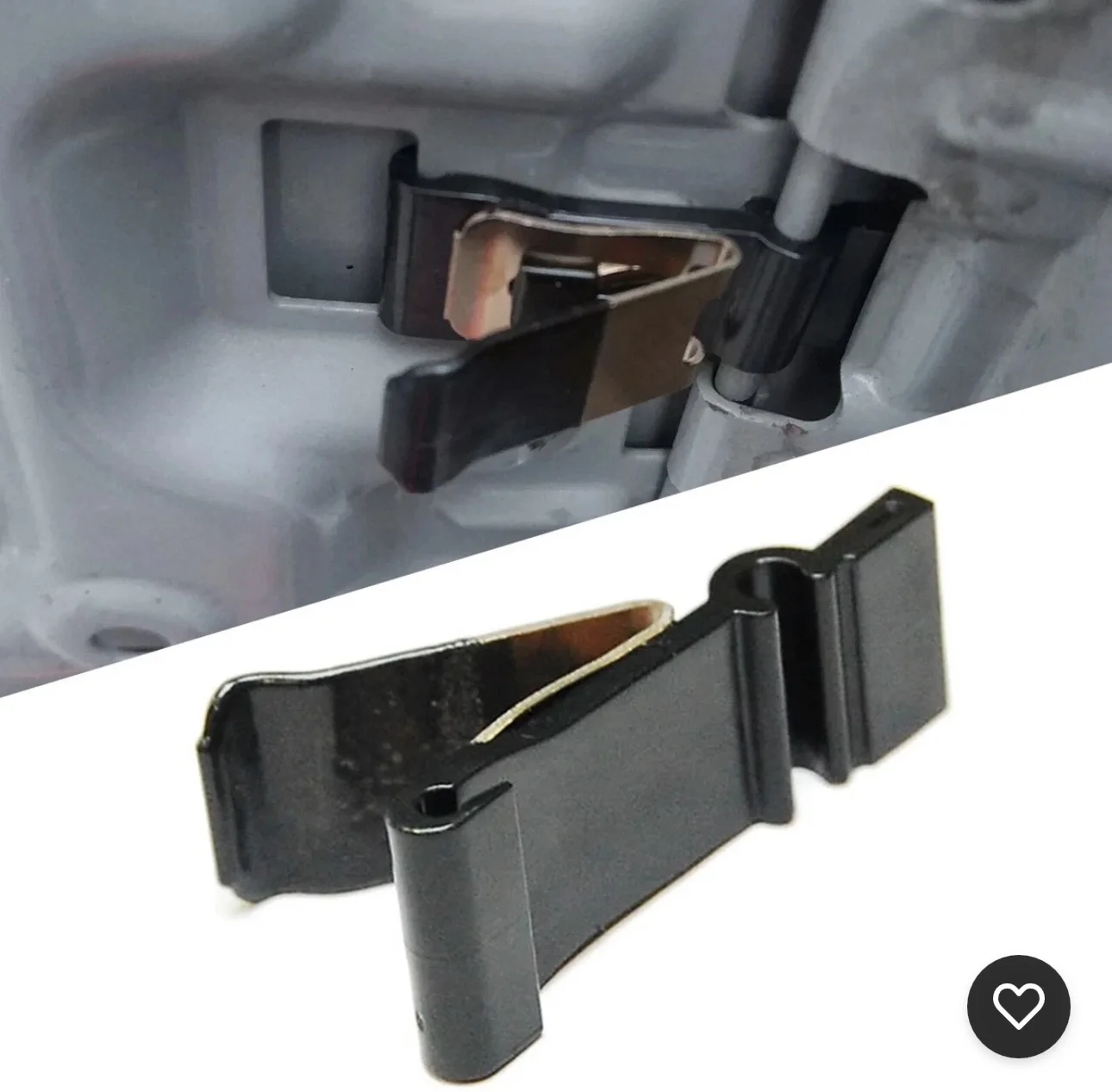

After 11 years of opening the door to fill my tank, I realize I don’t know what the spring is supposed to look like when it is correctly installed. Anyone have a photo?

I replace mine yesterday with the one from Amazon as a preventative measure and I had a heck of a time removing the old one. The "C" shaped part that clips onto the hinge was stuck and I had to yank it out with pliers using a little force. I don't think anything was bent, it was just stuck in there. The new one slid right in. My fuel door and spring don't look like the one in the picture above. 2010 LX

This is the latest part# I can find (77360-35040):
HTH
