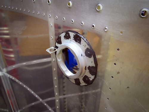

I think that would work as well. Most of the ones listed will work in a non pressurized situation. Let me know which one you go with. I want to do the same thing as in the pic. Heres a shot of my gas tank expansion tank. So far so good.
