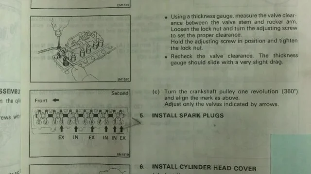

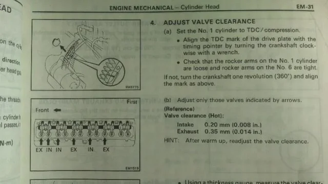

I'm pretty new to mud and I hear everyone talk about the field manual. I have a Haynes manual is that OK or is there better, and if so how do I go About finding one. I appreciate any input. I'm about to tackle a valve job on my 91 3fe
Here You GO
