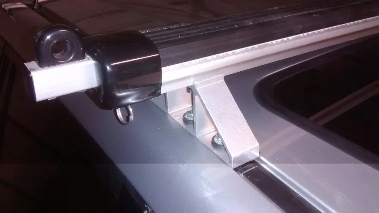

Decided to go with the Spring Creek cross bars, use the suction cup bracket (minus suction cups), and bolt in to existing points on roof. Anyone have a link to part numbers to cap the holes I will leave in the middle. Only using the front and rear points. Looks like I can modify them to work but won't know until I try.

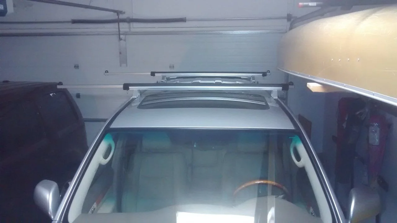

Installed roof rack from Spring Creek. Modified the suction cup mounts and bolted in to roof rack attachment points. I may tinker with it a little more but really happy with how it came out. These bars are extremely solid and extend to fit multiple canoes and what have you. Still need to order parts to cover the middle mounting point I am not using so part of old roof rack still there to keep water out.
Here are some pictures of how it turned out. I may make some adjustments still but this is basically it. Did have a some wind noise from 20 mph to 45 mph but could only hear with the radio off, which is a rare occurance in my car. The bars extend out to 20" on each side in 2" increments.

That's pretty slick looking. Has it worked out well? I was going to add a RTT, awning, and annex. thinking that those slide out bars would be perfect for that, do they lock in at any length?
What's the distance between the roof and just under the load bar extension piece? (thinking about mounting my annex and awning roll-up under it)

Thanks, like it so far. Great for what I got them for, hauling canoes and long boards. They are very sturdy. I am looking in to options to add rails and a different mounting system so I can slide the bars and take them off easy when I want too.
The bar extensions lock about every couple inches. Right now center bar holes still have part of original roof rack to keep holes water tight.
I am out of town this week without my Swank Tank but the distance is pretty tight to the roof. The bars are not perfectly level with each other due to contour of the roof. Another reason I am looking in to some other way of mounting them.
I bought the same and will be starting the install today. I already removed the factory rack. BTW, the center mounts can be removed and then have the bolts be screwed back in with their rubber washers...this looks to be water tight. How did you make the front and rear screw holes water tight? the rain channel indents at the point of the bolt, looks like a haven for water ;(
to even the racks out, I may try to shim the triangle mount itself.
Kumar
I picked up some flat rubber washers from Ace Hardware. Had to trim them a bit to fit in the channel. Don't recall the size. I took a bolt from the factor rack I re-used to the store with me to get a fit. I did not add silicone, just the rubber washers until the mount cleared the roof. Think I have about three thick washers per bolt. the compression seems to keep it water tight. Same concept as adding a weldless fitting to a brew kettle. You homebrewers know what I am talking about. I had to drill a new hole in the mounts which was not pretty because of the angle I had to take but it works and is hidden by the bolts.
Sorry for the late reply. There is only about an inch of clearance between the bars and roof front and back. The sunroof hits when tilted but I usually run it wide open when weather allows anyway.
