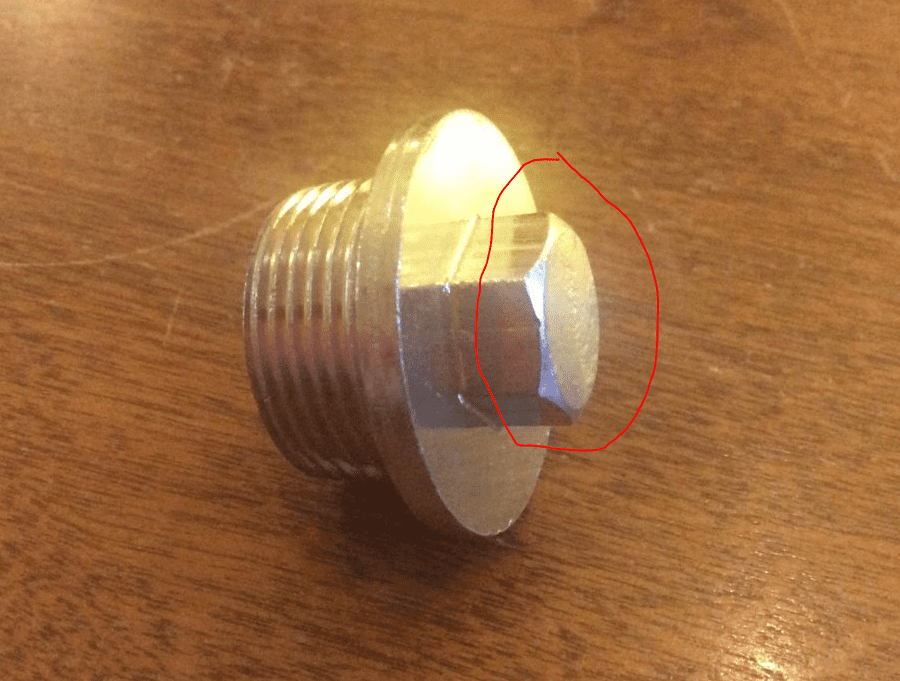

Greetings Everyone,
Anyone use this PLUG, STRAIGHT SCREW 90341-24016 for both front/rear differential and transfer case drain and plug? Just wondering if I can order 6 of them for front/rear diffs and transfer case drain & plug.
Found it here: Front diff drain plug alternate OEM part
PLUG, STRAIGHT SCREW 90341-24016:
Amazon product ASIN B01F7MAXX4
And Washers: Amazon product ASIN B07CJHTDVV
@NLXTACY sells them
But the above are still Female Hex Socket Plugs can easily be stripped out. I am looking for this similar 14 mm nut below to avoid stripping it out.
You’ll strip that head long before you strip the inset 10mm hex....
