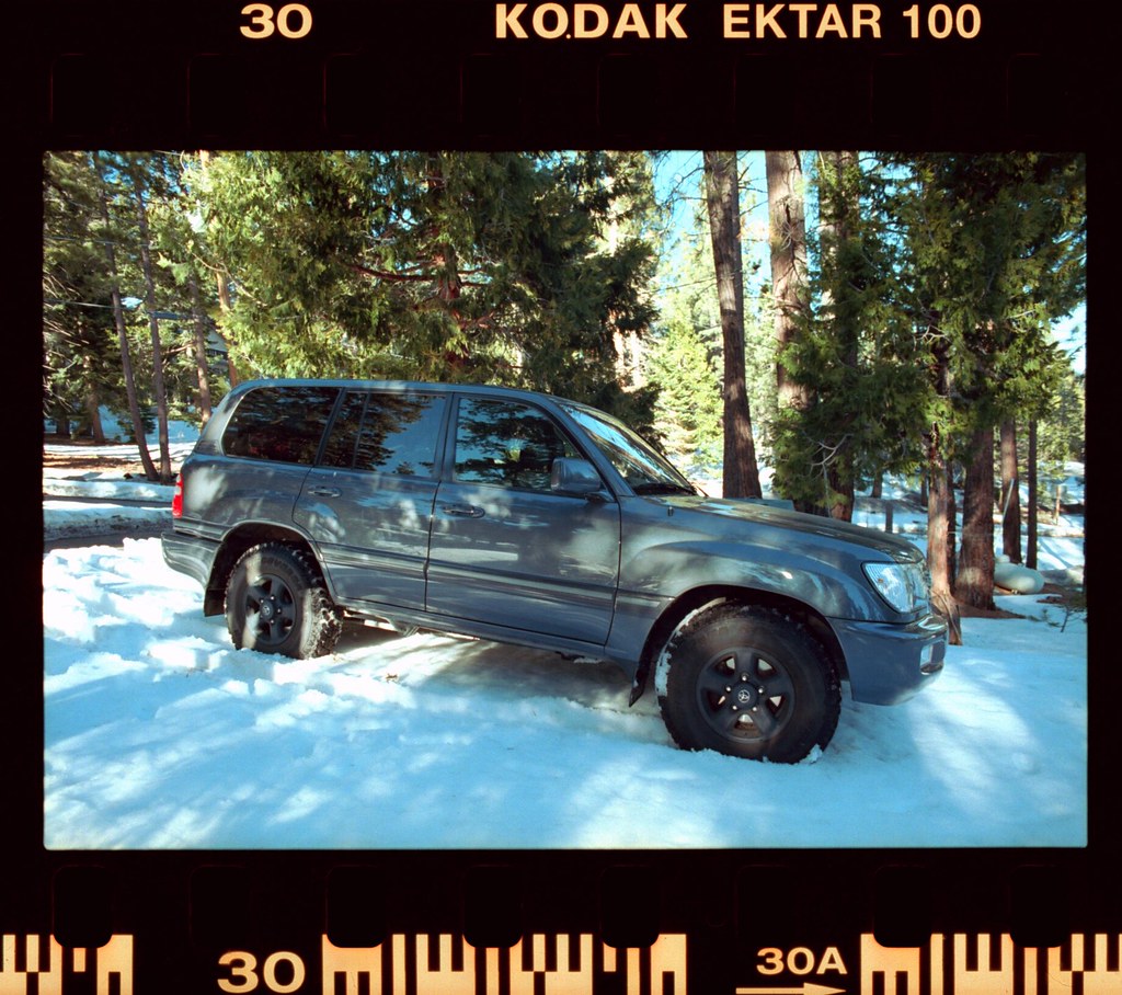

I recently removed my running boards and immediately started getting dirty doors and rockers from the front tire throwing stuff up. I figured it was only a matter of time before I started chipping paint from rocks getting thrown up, so I ordered a set of front mud flaps and brackets from cruiserdan. I asked Dan to send me whatever hardware he thought I needed, without even looking myself.
He sent me a few extras of some fasteners and not enough of some others, no big deal.
One kewl thing: he sent me two bolts and I needed six that size. It turns out that these are EXACTLY the same as the bolts that hold on Aisin hub bodies, the ones that go through the cone washers. The two bolts that Dan sent me are exactly the same in every way as the ones I had sitting in a jar from my 1976 FJ55. So now my 100 has Piggie parts!
The hardware that you need for this install, if you removed running boards and have never had front mud flaps:
The mud flaps themselves, part nos 76622-60060 and 76622-60070
The mud flap brackets, part nos 76641-60020 and 76642-60020
Two self tapping screws, part no 90159-60416 (you need four total, but will reuse two on the truck)
Two plastic nutserts for those two screws, I don't know the part number
Six of those bolts the same as the Aisin hub bolts, don't know the part number
