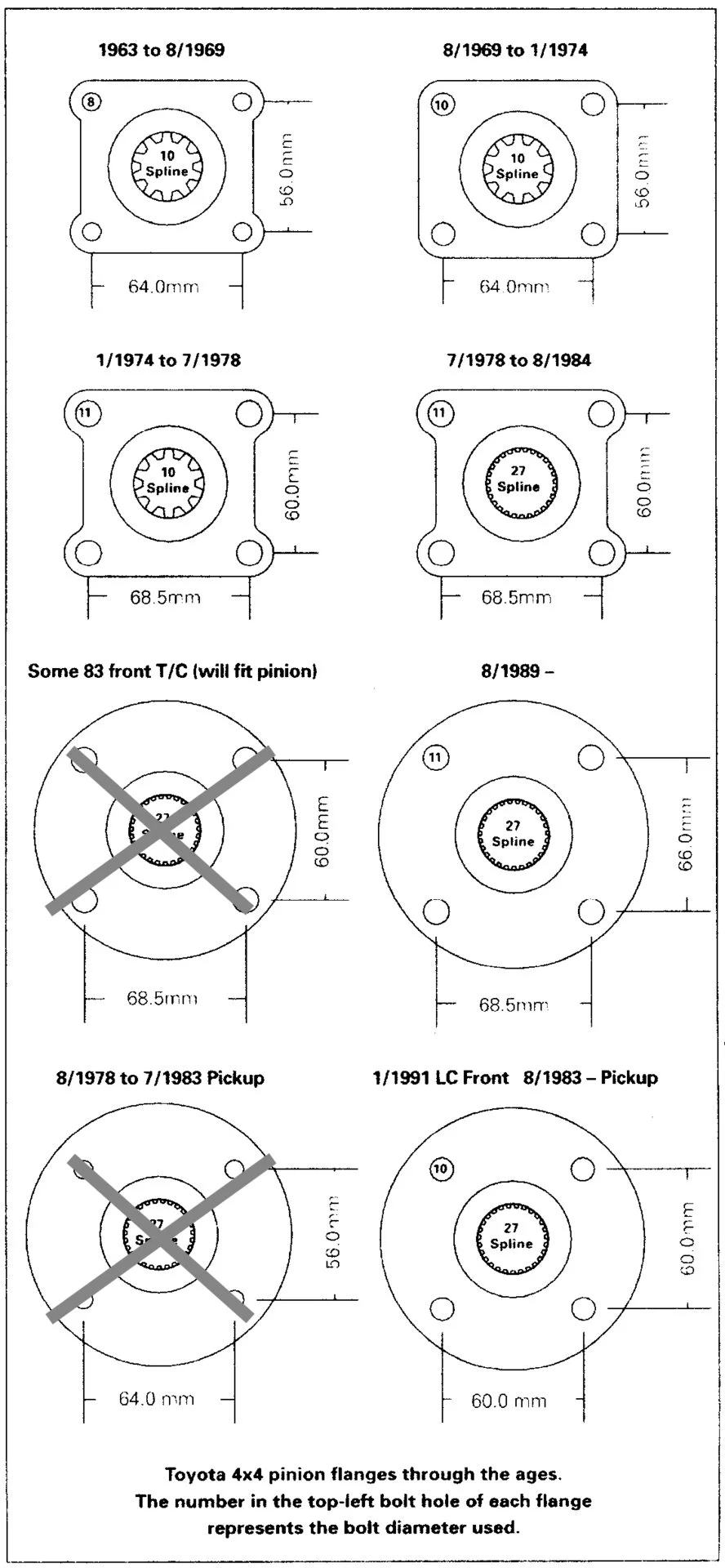

Aparantly there are differnt size front driveshaft flanges?
I have one from a manual trasnmission, and the frange is larger than the output shaft flange on the trasnfer case, hence the bolt holes dont line up.
If someone has a driveshaft they think will work for sale, please let me know.
