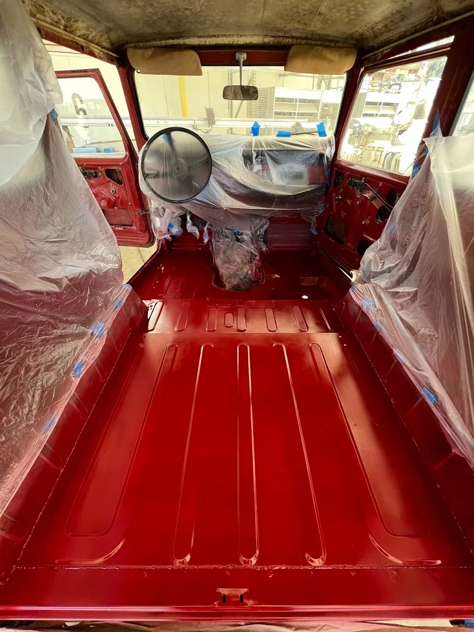

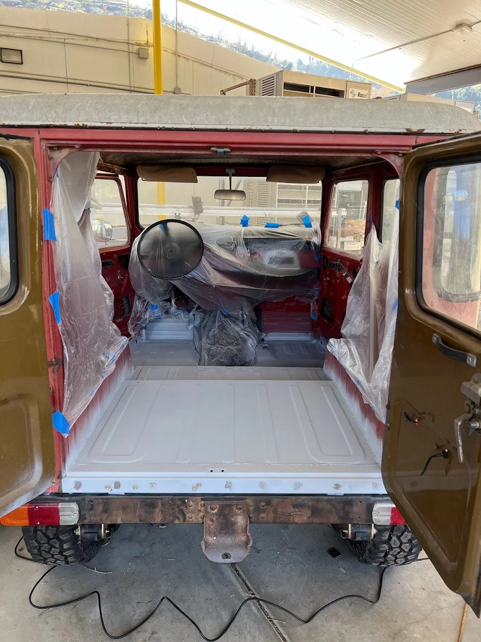

Hey everyone, I finally was at the paint stage for my floor replacement. Here is an update on the freeborn red paint from Cruiser Corps.
Used a 2k epoxy primer, sanded to 2000 grit.

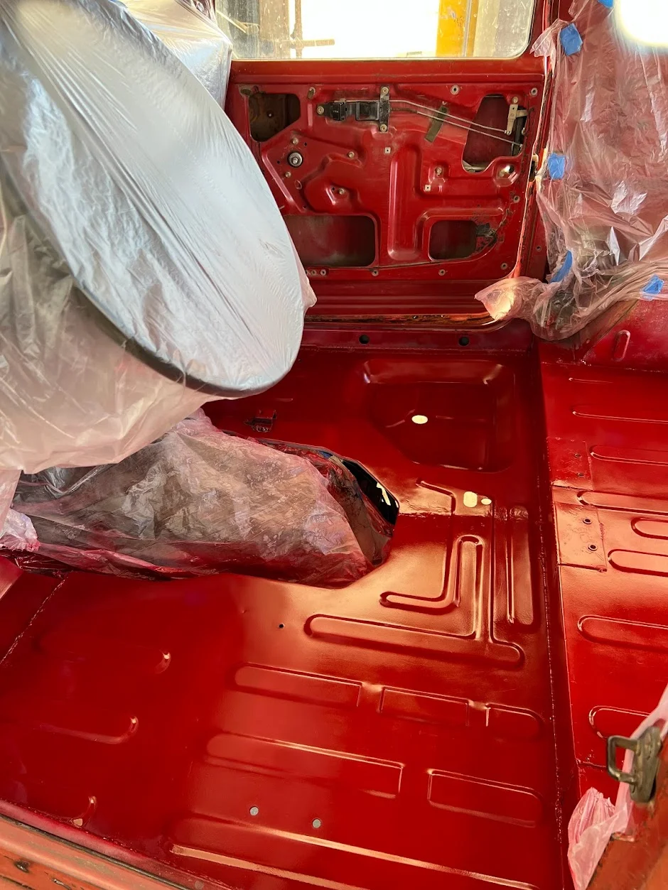

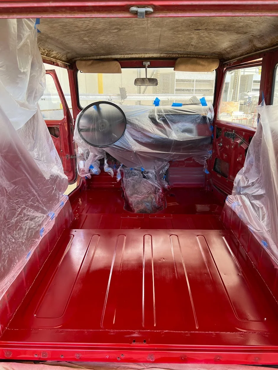

Then used 5 cans of Cruiser Corps Freeborn red ($100 or so bucks). I was able to do about 3 coats, and a 4th touch up. I am on a budget, so I'm using this as a hold over until I can spray the entire rig. This is after the first coat:
Third coat
Of course I forgot to take photo after the touch up and the 24 hours of drying... but overall I am very happy with the way it turned out. Gloss is nice, but not too much, it laid on well and even (there is some streaking in the photos above, but mostly removed with touch ups). Its very vibrant, and not too far off the colors on the doors. If you need quick fix, this could be your route. I personally wouldn't do this on the exterior, but for interior, I think it looks great. Let me know if you have any questions!
