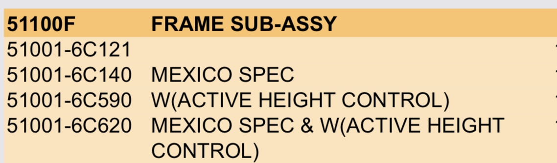

I would be really surprised if the AHC frames have a different part number because of all the mounting tabs for the AHC hardware, etc.
Surprise…
2006 LC
