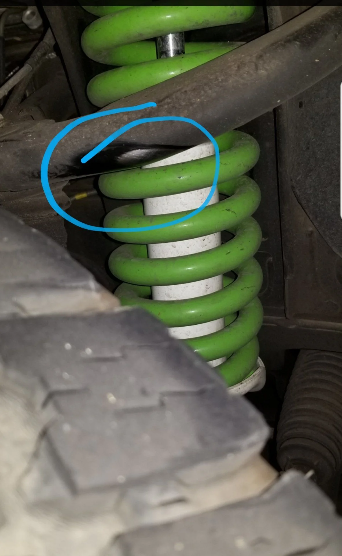

Bought truck a week ago with Ironman Nitro lift (has Icon springs in the back, fwiw) and 285/65/18 Toyo AT2's on stock 18" wheels.
Found the source of my rubbing...
I'm planning on 255/75/17's on 4Runner TRD off-roads, at +15mm offset v stock +25?
They're 7.5" wide v stock 8"?
So I should gain 10mm clearance between the sidewall and UCA from the reduced offset, moving the wheel further outboard, another 6mm from the narrower wheel (12mm/2), and an additional 15mm from a narrower tire ( (285-255)/2), for a total of 31mm (1.25") additional clearance? I give up .5" in diameter, or .25" of ground clearance, and gain a touch of sidewall, and get rid of my UCA rub.

The standard 6 spoke 2011 GX wheels (not sure if that's what you have) are 18"x7.5" wide with a +25mm offset, while TRD OR are 17"x7.5" with a +15mm offset, so the wheel alone will bring the tire 10mm closer to the UCA/Suspension.

I believe the lesser the offset number the more it sticks out. So a +15mm wheel will be 10mm further from the UCA than +25. It measures the distance from the mounting faceplate to the center of the rim. So the lesser the the distance, the closer the mounting face plate is to the center of the rim, which would push the wheel further out

Yes, should have clarified that I am running the standard six spoke wheel. Thanks for clarifying that they are 7.5" wide, so I'd lose 6mm from calculation. A smaller positive offset should move both edges of the wheel outboard, no? :lol: This is why I'm double checking before I drop a grand on tires :lol:

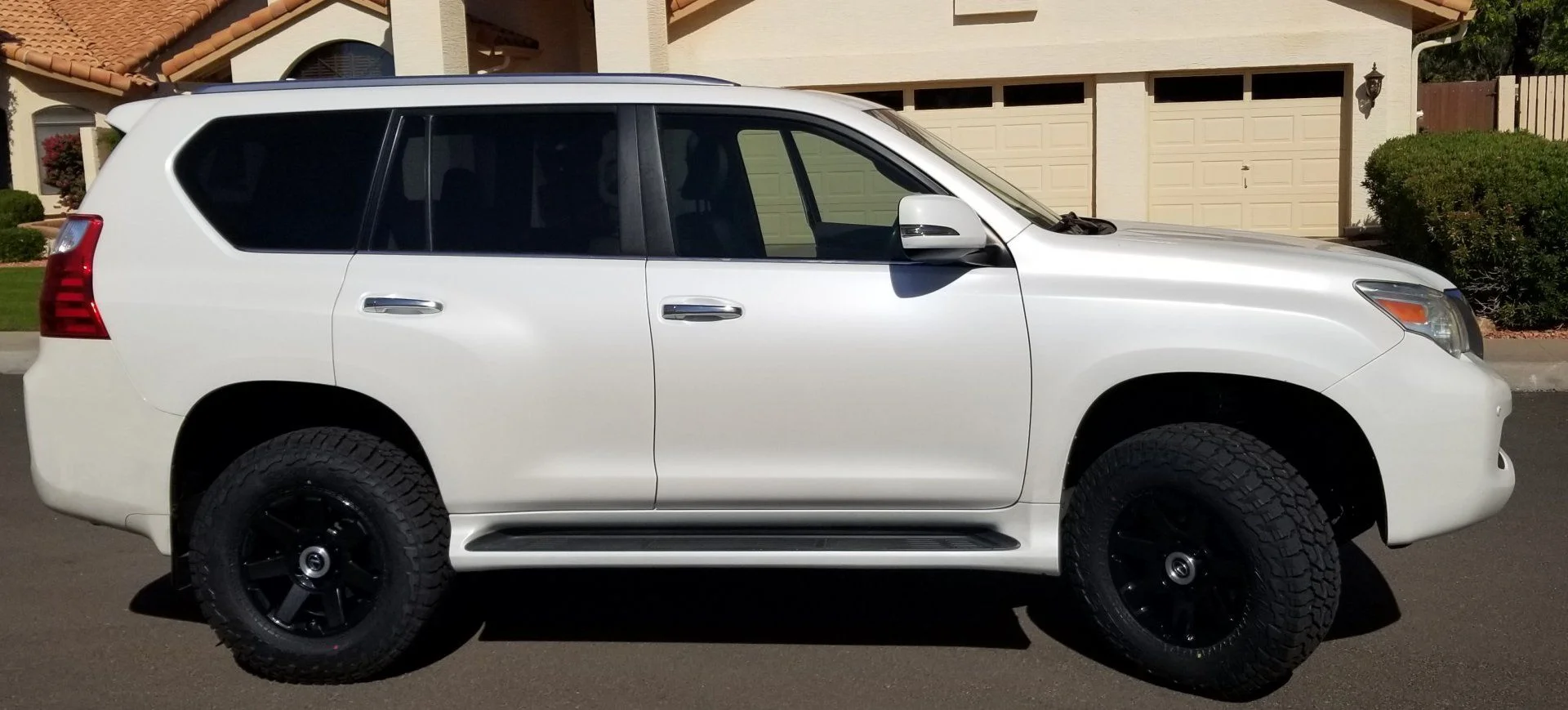

New wheels and rubber on! Falken Wildpeak AT3W in 275/70/17 on TRD off roads painted black with Lexus emblems on the center caps and black lug nuts. No rubbing on the UCA, still need to stuff a wheel, but plenty of clearance on pavement.

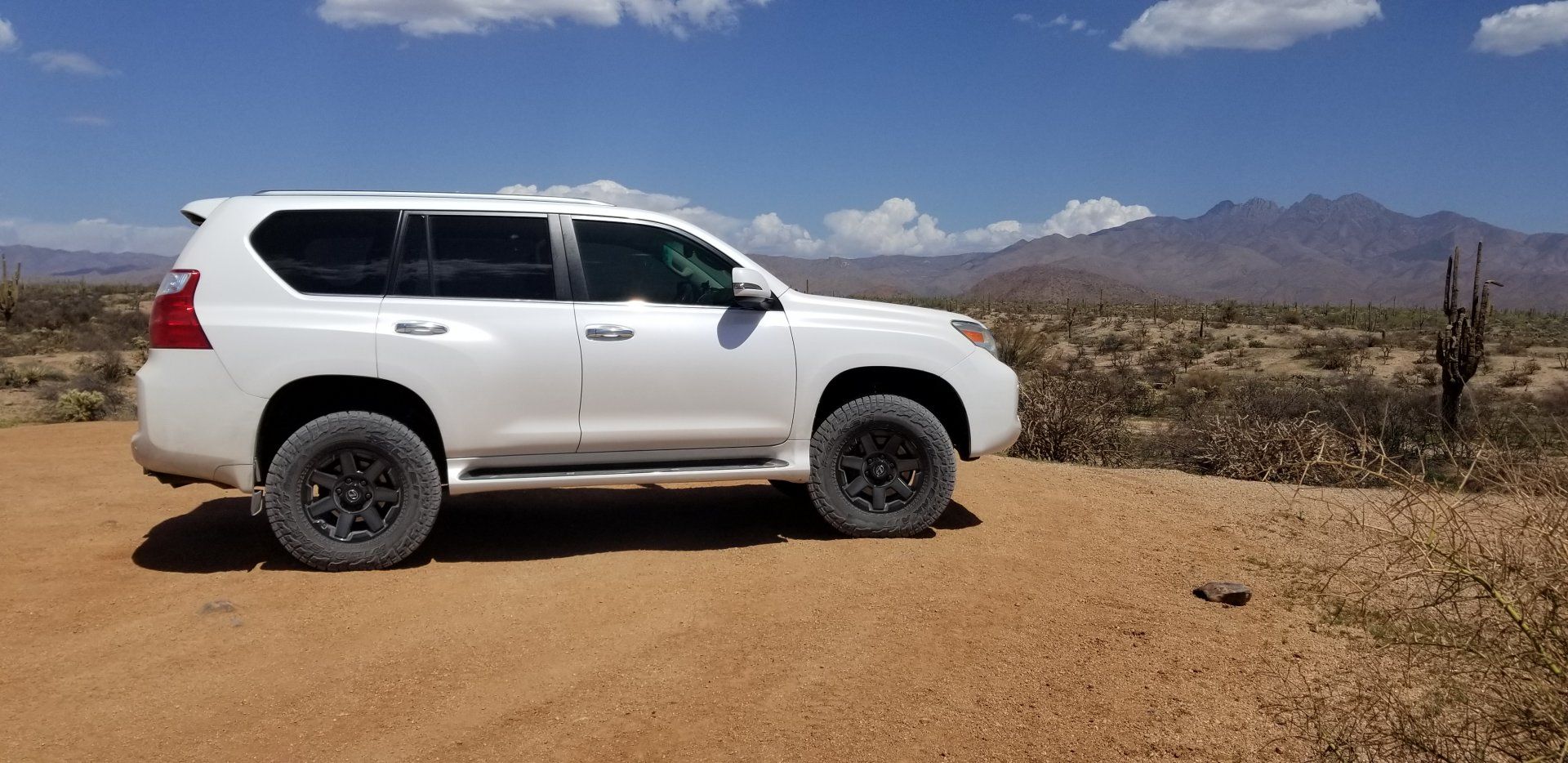

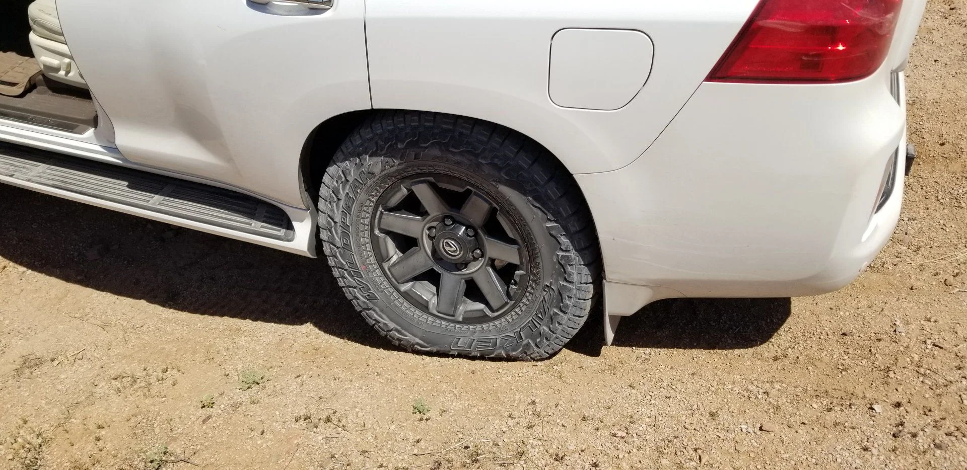

Took it out to the local playground to test out the new wheels and rubber. My first time off road in the GX, and it did not disappoint! Better than my 100 series!
And this is why I went with the C rated Falkens instead of an E rated tire. 16 psi soaked up the rocks and allowed great traction up and down the washes...
And a few more for fun...
