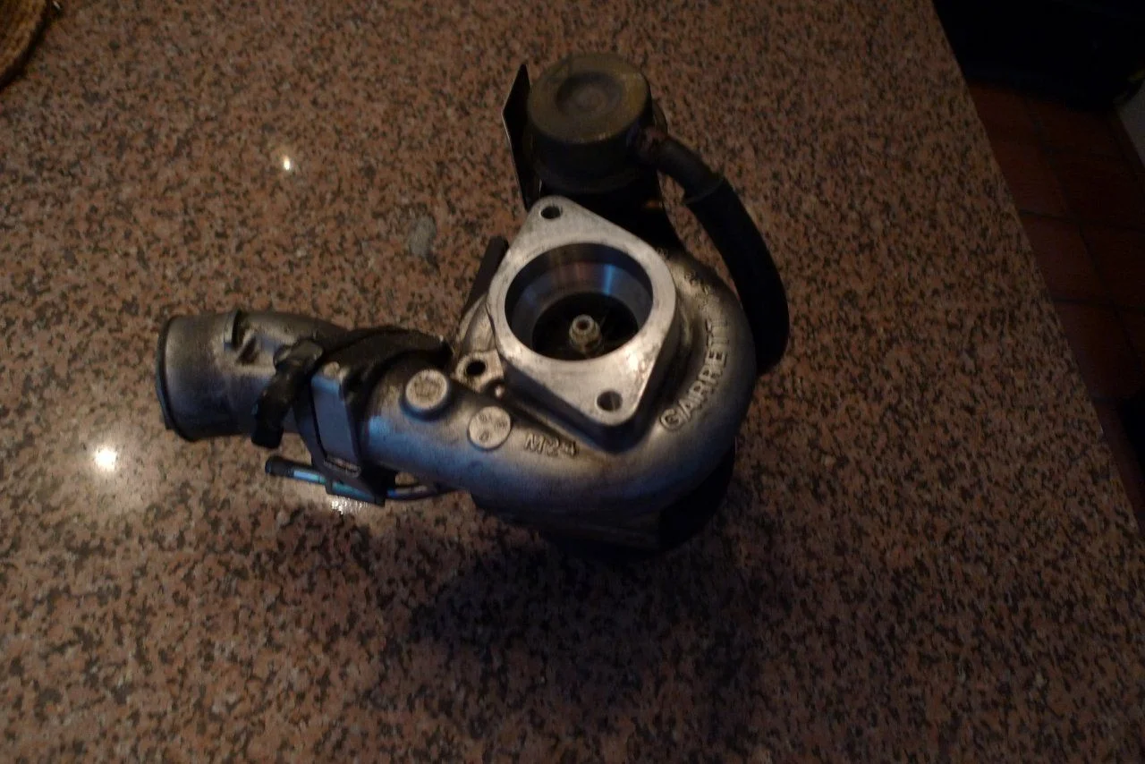

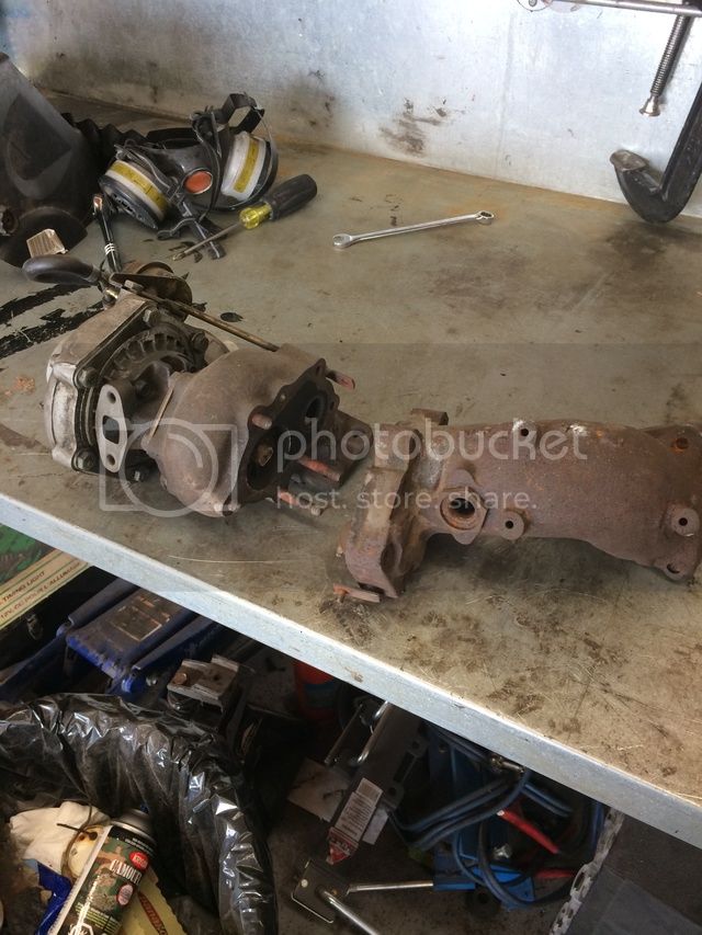

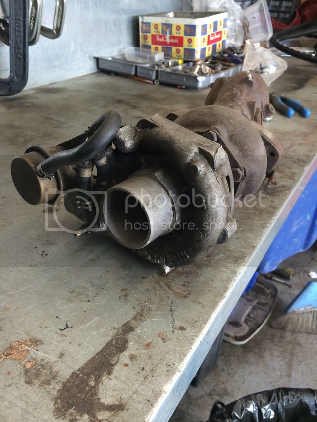

Here it is, it has a weird exhaust housing on it. It has 7 bolts where I think the Garret's have 5. Other than that it seems to be in decent shape. No slop
Graham,
You could try chopping that downpipe after the flange and tig welding a stainless elbow on there. Stainless can be tig'd to cast but for the record I don't know how it will like the constant vibration and heat cycling. Worth a shot I suppose.
The other option would be to build a new downpipe from scratch. A flange might be available on ebay..... after that all you would have to do is build a downpipe that incorporates the wastegate dump.
I could for sure make up a much simpler down pipe using the existing downpipe. bend up some stainless and a watercut flange
do you know any of the AR values?
I don't, couldn't find the numbers on it. Looked pretty similar size to the Garret turbos though. I'll bring it to the next meet. Next week maybe?
