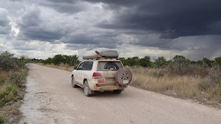

If you look at the pictures of the grey 200 series here, you'll see a very close approximation of the maximum fording depth, as its automatic tansmission failed shortly after this trip as a result of water getting into it. The white one, on the other hand, had no problems whatsoever.
The grey one is completely stock, while the white one has a 2"/0.75" OME lift on 285/70R17 tires.
