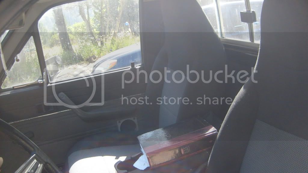

This morning. The console is folded down, and I have a book on it.

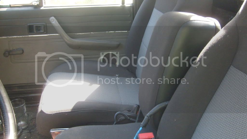

With the console folded up for "bench seat mode":

Bottom line: These seats are great, they put me at a better angle pedals-wise, and they ride so much more comfortably. They are much taller, though, which is fine with me, since I'm short.
They're much firmer and considerably more "truck-like" than the racing buckets, and the center console is incredibly handy.
Bottom line: Do Ranger sets fit into a 79-83 Mini?
Yes.
Are they easy to install:
very yes.
Do they work?
I believe they do, and as long as you're either short, or able to weld and lower them, or fab up a mounting assembly for them, they'll actually work well. Visibility is greatly improved (what blind spots?), ride quality is the best I've had in this truck, and the angles on the pedals are much, much better than either previous set I've had in this truck. I would do this mod again.
