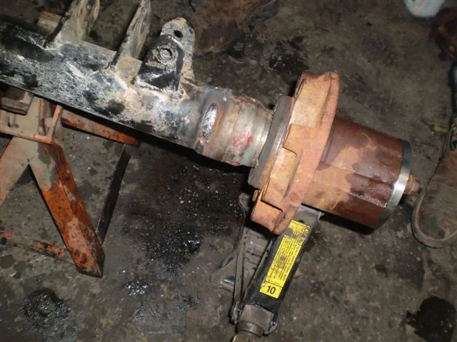

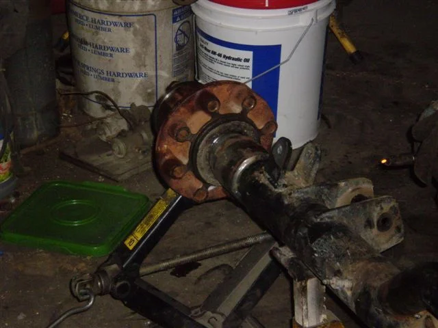

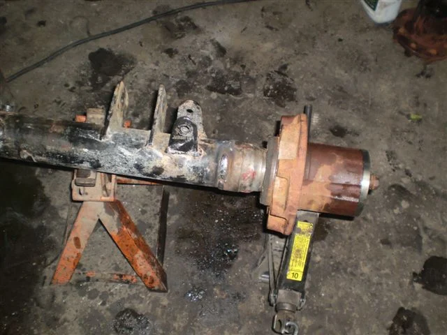

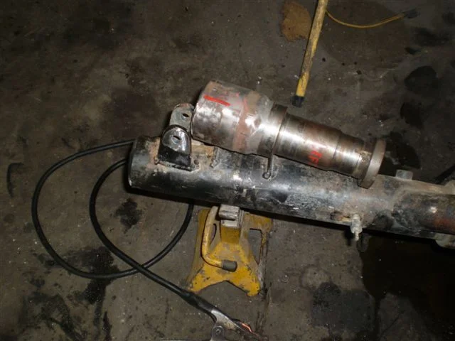

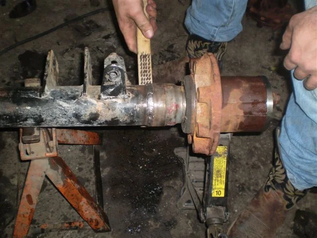

Josh had the spindles bored for 35 spline axles when he built the truck, PITA to get it done guy that ended up doing it requested no more to do.
We don't really know what happened but at last years Roundup the rh side axle drum and end of the spindle came off with the locking nuts attached, looked as if the axle was rubbing on the tube and welded itself to the spindle.
He has 6 something gears in there which are not available for the 14 bolt, I had a used 14 bolt we swiped the outers from and he order a pair of Moser axles to couple them on.
That sleeved at all Butch?

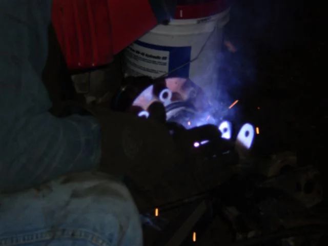

when I left to go to the LSLC meeting this evening he was welding the caliper brackets on, it should be ready to install under the truck now

When I was in ship building, they beveled everthing and ran a weld, but preheated prior to get the moisture out which can cause issues.
They never sleeved it and it had to hold 16 ton drives.
Rob
Never said it was impossible.. :flipoff2:
Also, that metal has a ton of oil in the pores.
