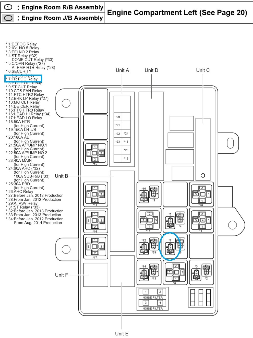

I would check or suspect the fog light relay in the engine bay fuse panel. The relay may have been failed in the on position.
What fog lights are you running and did you make any further mods?
Here's a diagram for the early model year 200s. May be slightly different for a 2013?

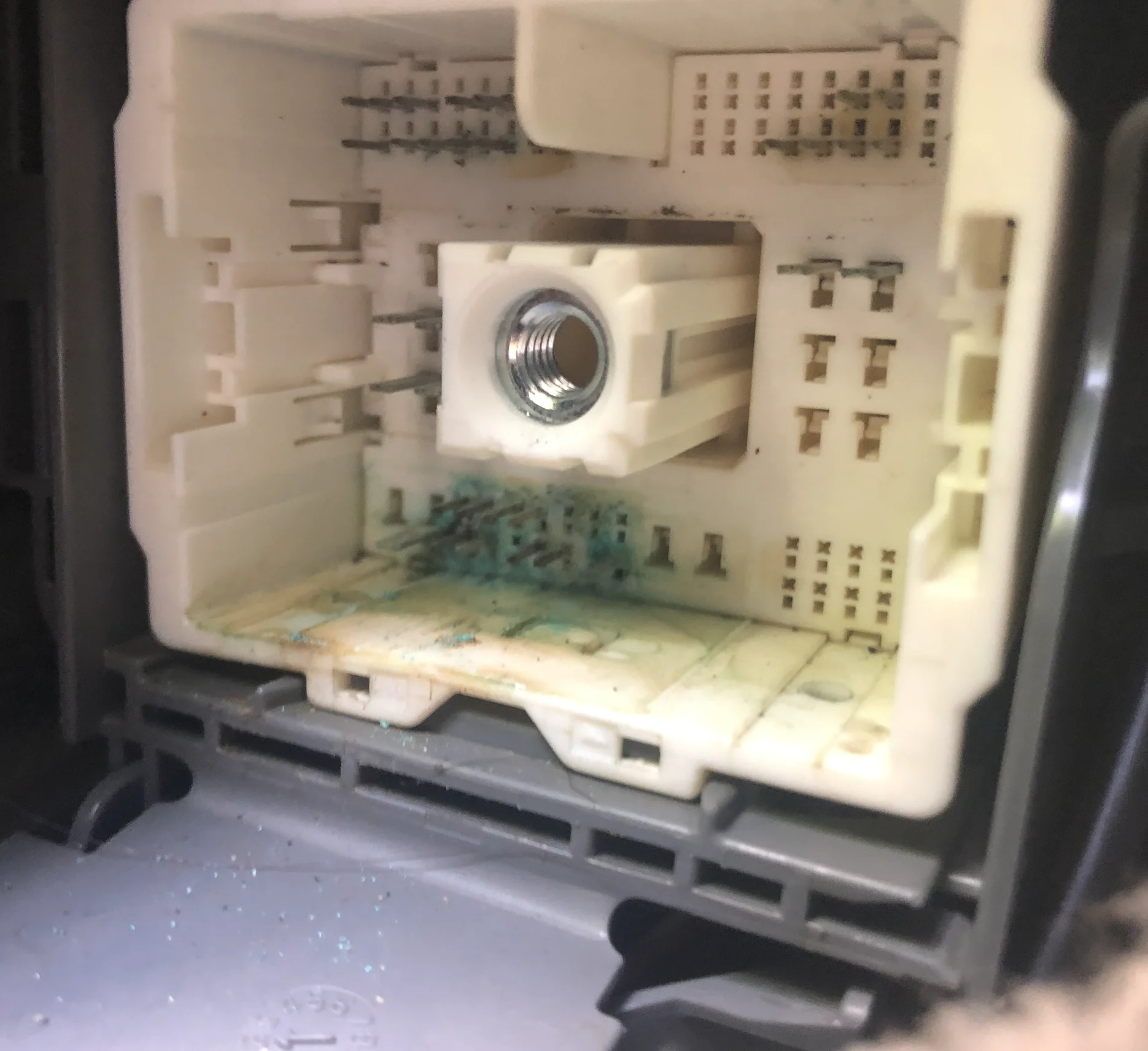

Check the connectors in the A-pillar on the driver's side. If your sunroof drains are / were clogged and flooded the a-pillar, you will find corrossion in those unsealed connectors. Had this same behavior on my truck and that was the issue. Unfortunately, I had so much corrosion that my rear AC is now non-functional. Going to be a very expensive repair I really wish I'd found earlier.
These are the stock fog lights. No mods. It did rain last night.
Look at this connector in the d.s. kick panel below the a-pillar:
Water. You have water in your driver side lower kick panel, as shown above. Open it up and dry it out. Thats my bet, same exact thing happened to my 2013 after a heavy rain storm. Sunroof drain was clogged.

The carpet on the drivers side is wet, so I do think the root cause is the sunroof drain.
I would highly advise against that. The dealer will charge you 100s and probably tell you you need to replace your flux capacitor which will cost 1000s. You can fix this problem in about 30 minutes yourself, its very easy.
Disconnect battery.
Then pull the lower door entry trim, then pull the kick panel to the left. There will be several big, white plugs that are bolted in place, as pictured above. Loosen the bolts so you can unplug them. Take a hair drier and blow it out.
Vacuum out the area around the sunroof drains from above. Feed some weed eater line through the sunroof drains. Pour some water down to test and make sure it comes out under the car.

You may want to pull the relay that @TeCKis300 pointed out above, And then see if they turn off.
Sometimes those relays get stuck in the closed position giving the item power 24/7. I could just be the replay is stuck, and if that is the case just replace the relay.
When you pull it out You can check it with a multi-meter for continuity.
Just solved the exact same issue. After pulling and inspecting all the a pillars and kick panels and cleaning the sunroof drain and finding nothing and blaming it on my windshield replacement, I reread this post and pulled the relay. It's bad. Thanks!
