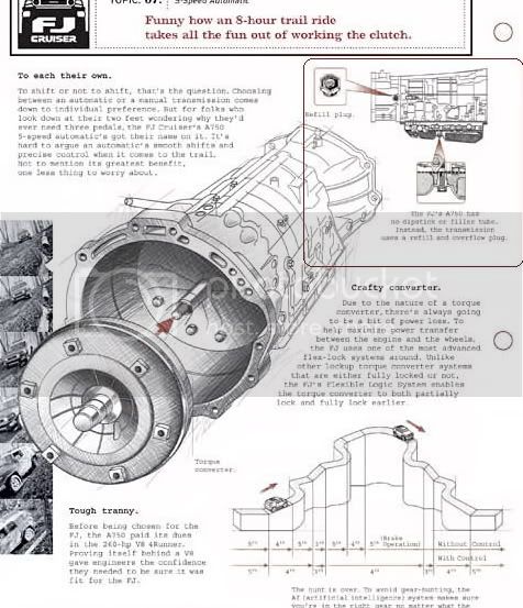

Check with dealer or tech manual to be sure but I've been told, and my research supports this, that there is no drain plug for the transmission.
mmmmmmmmmm...............s***ty picture but that is definitely a drain and fill plug
Edit: looks like it might be under the pan, but is still a drain plug.
mmmmmmmmmm...............****ty picture but that is definitely a drain and fill plug
Wow, now I'd recomend calling the dealer or other authorized service center prior to trying to use that "plug"...:flipoff2:

It's not a lifetime fluid, it's got a 100K change recommendation from Toyota, 50K would be more prudent if you go off roading or tow.
Pulling the plug will drain some of the fluid out but not all. Most all who have it changed have the dealer change it.

Anyone have the FSM? The ad makes it sound like you can drain and fill to the plug level, wait, that's exactly what it says, anyone have the FSM and what it says?
