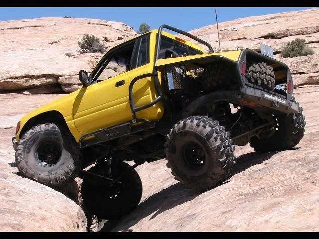

Compare the attached picture. That was when I was running 860 springs in the rear with 2" spacer (ok body does not count). This is the top section of the crack as Robbie mentioned. Did not lift a tire. The difference is that I am running 14" travel Rancho shocks with the mounts on the rear moved about 6" up to accomodate the longer shocks. Also notice that it is mostly the rear working and not the front. No swaybars.
