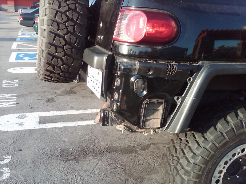

Here is some info on my rear bumper build. I decided to go custom since I wasn't too excited about the current options, especially the limited choices for swingouts. After talking with a two 4th generation 4runner guys over at toyota120.com, I decided to go with 4x4 Labs in Grass Valley. He made bumpers for these guys and after seing one of them in person, the decision was made. He's popular with the IH8MUD crowd, and has developed trick rear swingouts for the 60, 80, and 100 series landcruisers. Luke, the owner is basically a one man shop. As you can see from the pics, he pays attention to small details. He's not only concerned with functionality and strength, but he really wanted this bumper to look cool. Anyway, on to the pics...
First thing, rear crossmember chopped...not for the squeemish.
