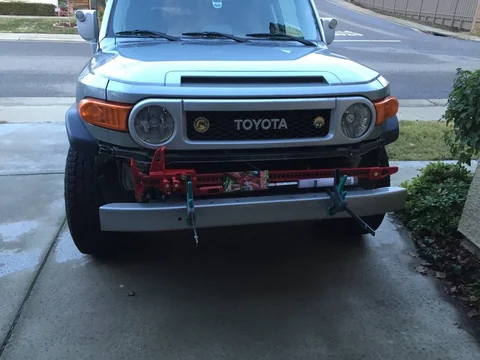

Well, took the plunge and pulled off the stock OEM bumper, staged a mock-up of what the FJ40 bumper and Hi-Lift jack initially looks like, and I've got to say, it ain't half bad looking...(I will post pix shortly...I hate this part of trying to download photos to create a URL - any suggestions as to the easiest way to accomplish this?). My biggest concerns is the exposed water reservoir on the passenger side and the aluminum cooling coil that juts out in front of the radiator. I'd like to try and rig up some type of cover over the water reservoir, so I'm open to any/all suggestions. I will be using a 6" angle iron brace bolted onto the bumper extensions to hold the Hi-Lift, and a flat iron bracket bolted onto the front of the existing FJC aluminum bumper to attach the OEM FJ40 bumper.
I look forward to your input/comments/suggestions...
