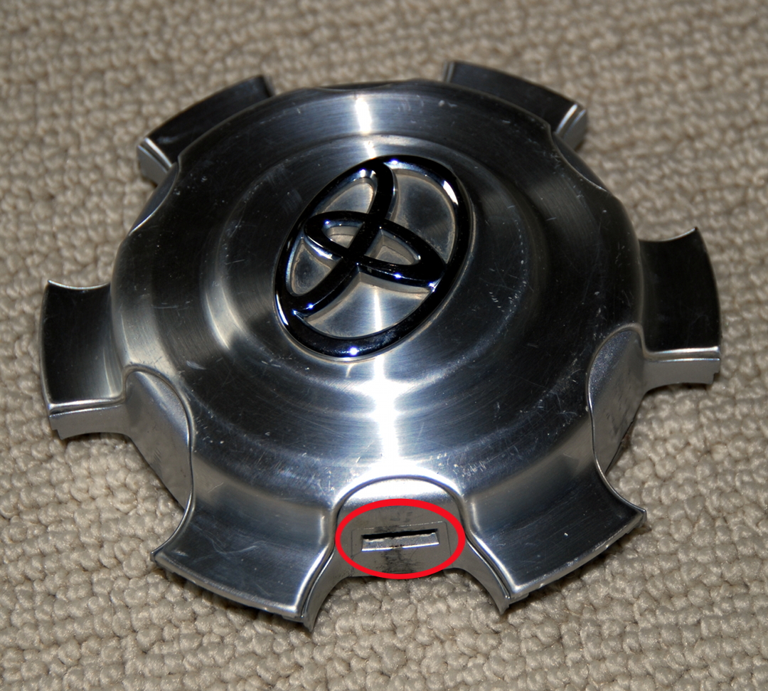

On my Runner and TLC I can pop 'em off by hand. The FJC center caps feel too tight and like I might break something if I use this technique.
Is there a certain way, or can I just pull them off?
These are on '07 alloys.
Thanks!
If you are referring to the center cap on the stock FJC wheels, they are just held on by the pressure of plastic clips and wire ring pressed against the wheel... there is a slot on them for using a screw driver or small pry bar to loosen its grip. I just give them a little presure with a big screw driver and they usually come free.
Thanks! I saw the slot but didn't want to get hasty and bust them up. Off they come this evening!
