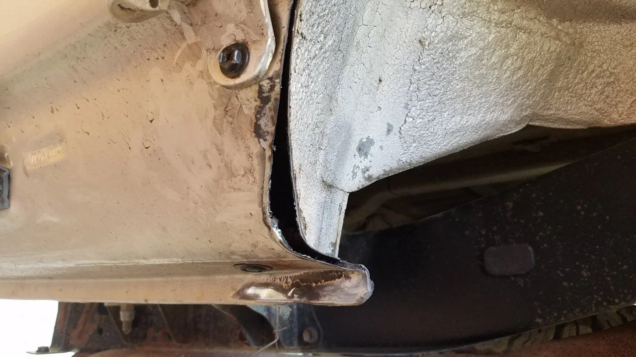

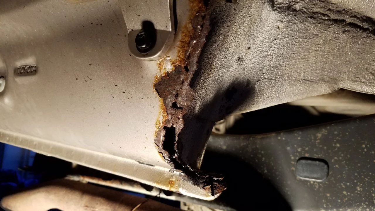

After I got the wings on, I noticed a GIANT rust spot where the passenger rear mud flap bolts in to the body
I got out the grinder and cut all of the rust out, and cleaned everything up.
Once all the rust was gone, I started fabricating a bracket to weld in. This was a very complex part for me to make, so it took pretty much all day.
I used some Bondo to smooth everything together as my welds were less than perfect, and I soaked it in primer and paint to make sure it won't be rusting again anytime soon. Now the mud flaps are ready to bolt on!

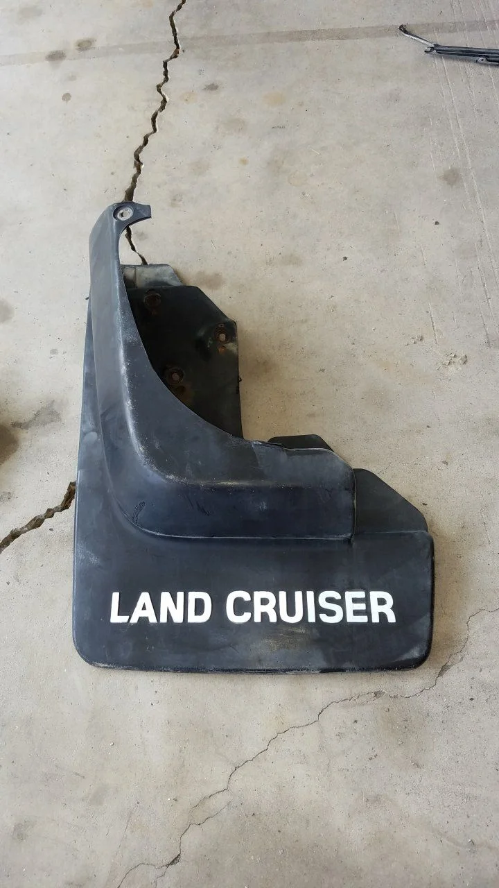

As I was about to attach the mud flaps, I noticed how old and beat up they looked.

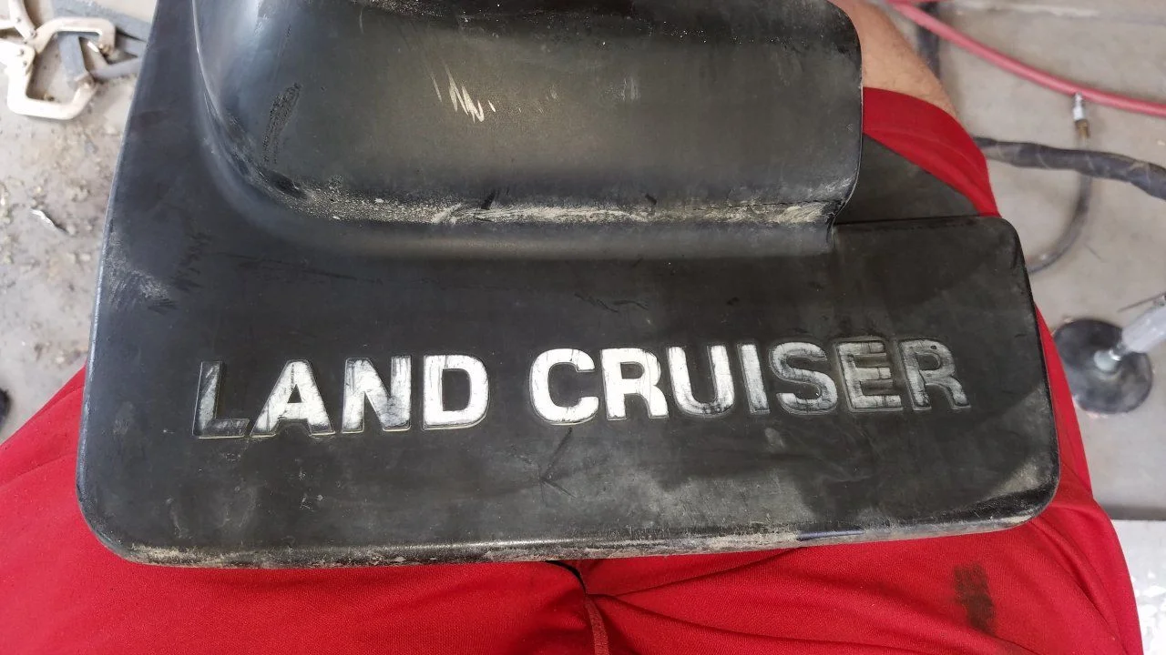

I got a nice paint marker, and went to work.
I still have to clean up a few places, but they look pretty good in my opinion.

To start with, I finished up the mud flaps, and I have to say, I'm more than pleased with how they came out.

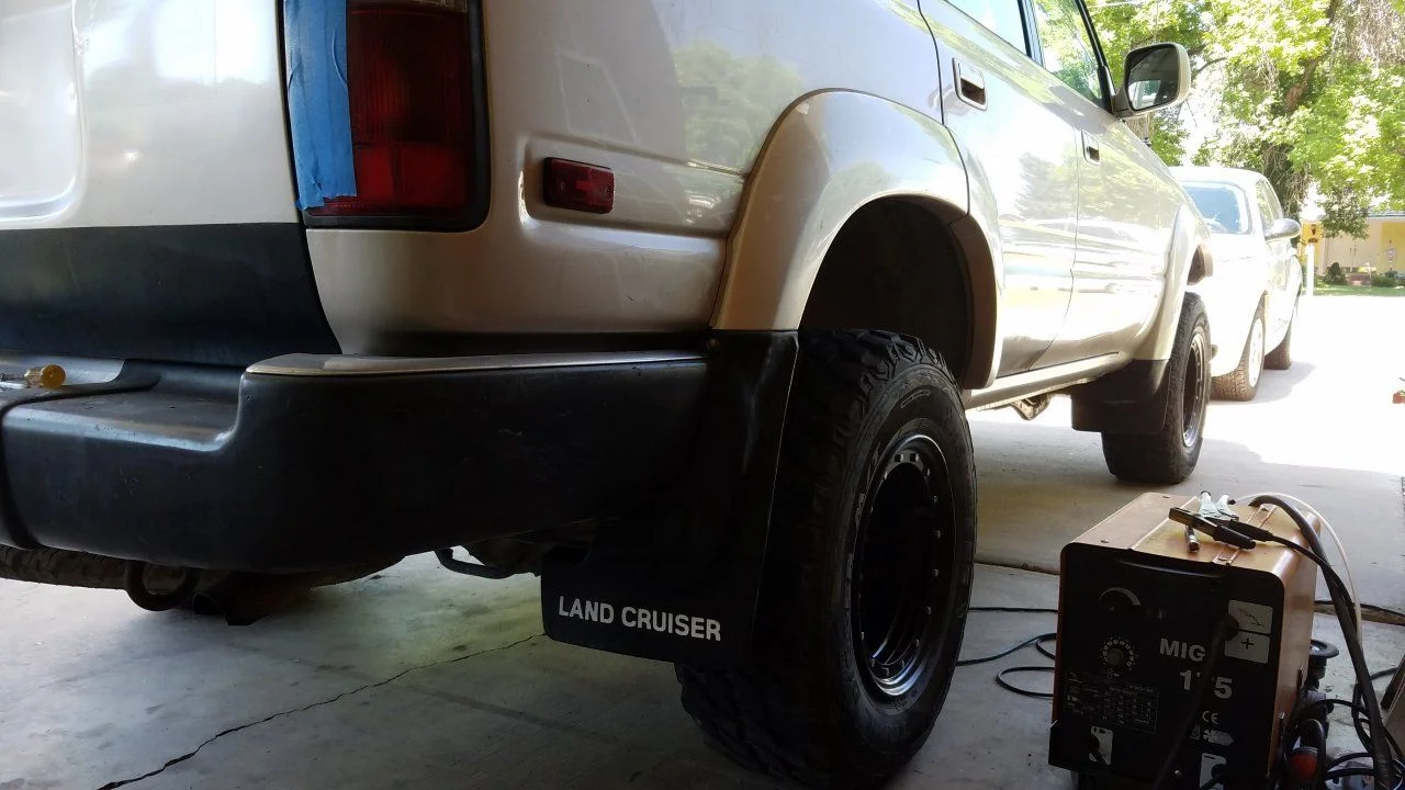

After they completely dried, I got them installed. Lookin' good!
