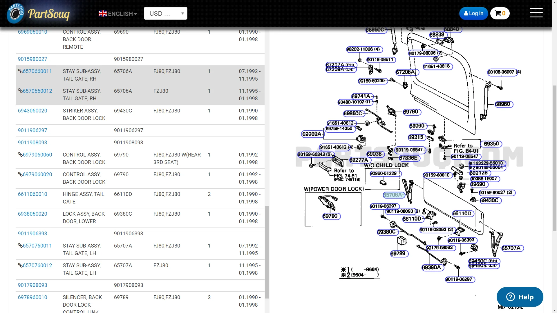

Has anyone ever had to change the bolt for the tailgate stay. One of mine is bent but toyota says I have to order the entire arm to get it.
Any solutions to it?

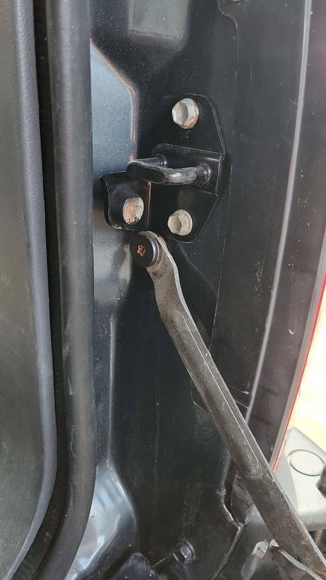

Are you referring to the one with the Phillips cross in the head of it?
Mi
Mine wernt pressed it. Mine just had a washer behind it. So should be able to separate

You are correct. You can only get the bolt by buying the whole assembly. There are also 2 or more little washer bushing things that you will get with the assembly.
That's why this is hard to replace with a regular bolt because you need the washer/bushing things.
I lost the bolt on my rig. I came up with a simple solution that I like more than the oem set up.
Post in thread 'Tailgate support hardware' Tailgate support hardware - https://forum.ih8mud.com/threads/tailgate-support-hardware.1235254/post-13539419
In the above post I used cable that was coated in plastic. After a year the plastic separated and let the clamps come loose. Than I re made it with cable not coated in plastic and it has held up great.
