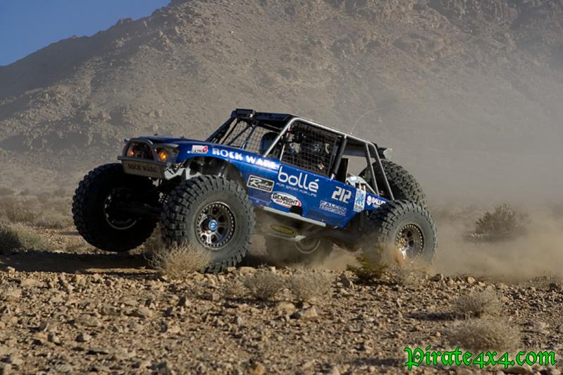

Sounds like a waste of time. This is the hard core corner, Breakage on hard core trails SUCKS..
Do it right the first time with quality design, and parts, Or Leave it alone!!
For what its worth, this rig has radius arms with Stock FJ80 Bushings and it finished 13th place this year at the hammers.

That rig also weighs about 1/2 of what the 80 weighs and has a $5K shock package, BUT I agree do it right the first time. Awesome pic
Why would experimental fabrication mean its gonna break? I dont weld with a battery. Where do you think alot of the normal things done today like 63" Chevys come from, a F#%%^ing computer. IM glad a $75K buggy in a picture still has radious arms, but Im not going to KOH and I dont have a buggy. If you only use off the shelf parts dont reply to threads involveing creativity. :cheers:
Chill.... They're just saying why bother if you're going to do it with cheap heims and end up redoing it later - not saying you need a 3D model to do it - and just pointing out that the radius arm set up has potential w/o ditching it and going 3-link, especially, a half arsed 3-link. It's the cheap heims that are going to break under a 6,000lb truck, not that it's experimential fab.
Got anymore fotos of that rig. I can't see the arms there. Did they modify the mounts at all? I would like to move my arms up as much as possible and if that means re-using parts... then win for me, that's how i fab.
