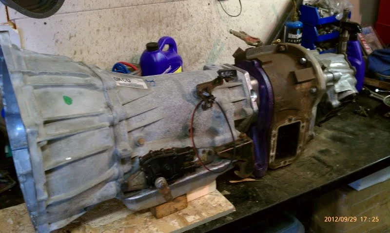

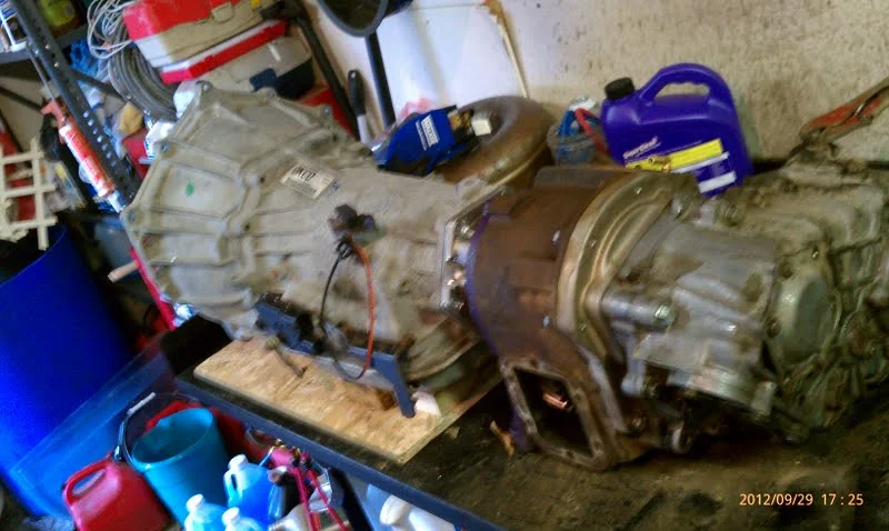

I finally took some time to work on the FJ62. For those that don't know it is getting a 5.3l, 4l60e, Np203 range box doubled with a split case. This past Saturday I did a mock up of the trans and cases. Trans is freshened with some nice new goodies and mods. Shaft is changed with AA's shaft to mate it to the 203 with a vss for the fuel injection. Split case and 203 are mated with a CO OR EXP kit made by AA. Frame is cleaned up from many months ago, motor mounts are made but not in. I'm hoping this weekend we can put the trans on the motor and swing the whole mess in for a test fit and tack the motor mounts in and line up a trans crossmember.
