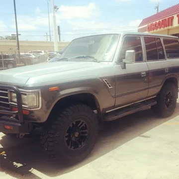

Classic 2's bolted right on. No spacer needed. Although they are discontinued, First Choice Wheels have plenty in stock.
Which ones bolt right on? I looked at their website and they have a huge selection.
