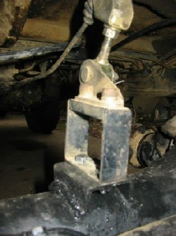

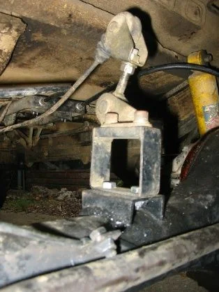

    Here are some pictures of my LSPV spacer. A buddy of mine made these a couple of years ago, but it would be pretty easy to do. Do note that the bracket where mine is bolted is home made. The full floater I just put in didn't have a bracket for the LSPV, so I made the one you see.

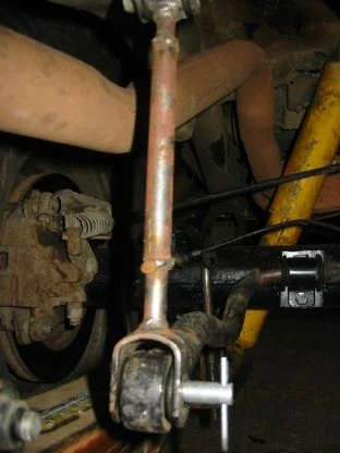

    Here is the extended sway bar. I cut the stock one, sliped it into a piece of 1/2" tubing with a piece of round stock in the middle. Tack weld the tubeing to hold it together. You have to take a tiny bit of material off of the sway bar round stock to get it to slide inside the piece of 1/2" tubing.

    Thanks a lot for the pics euclid, so the long run of the lspv arm should ideally be paralell to the ground or even a bit elevated? Ive got to tear into the rear axle this coming weekend to re-shim my locker, so i should have access to a well stocked shop to do a little fabbing.
    Do you really feel the rear bar helps your handling? I pulled mine when i did my locker install and left it off in case i needed to tear into it again (too bad i have too...) and havent really felt any difference at all. My rear springs are pretty stiff though.

    Sway bar: I have tried it both ways on several different suspension set ups. I think on the OME orgionals with OME shocks I can tell some diffrence. Not a lot, but some. I do have a full length roof rack, which changes the center of gravity a good bit.
    On the LSPV: the spacer keeps it at the stockish level. To adjust it I fiddle with mine till I like the feel brake proportioning front to back, then I figgure if it does it's job I'll have that kind of brakeing no matter what the load. I'm experimenting now to try to make the new rear disks lock up just right. The book has a bunch of tests to do if you want to get technical on it.
