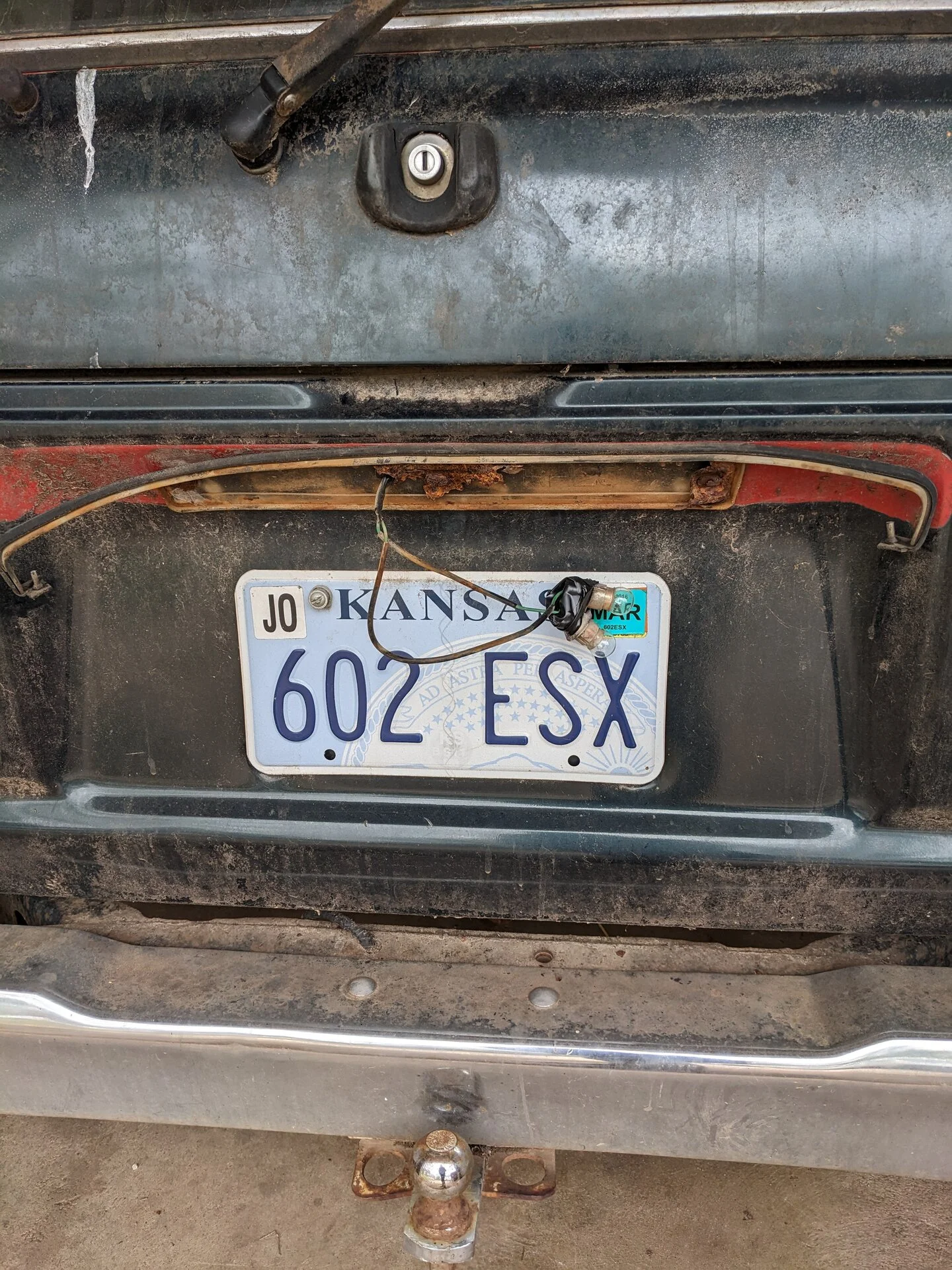

The chrome trim piece was dangling just barely attached to one of the bulbs when we went to pick the truck up. Still pondering how I'm going to reattach it. Just glad my bother thought to pull it off and toss it in the back before we hit the road.
Unless you fabricate something, your best bet might be to clean it up real well and use extreme double sided tape. GL
Yeah I can easily bend some metal tabs that'll work to mount the trim piece back in place. It's remounting the bulb sockets that'll take some creativity. I reckon that from start to mounted and ready for picture day it will be a four beer job.
