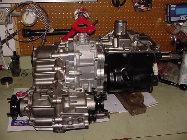

yup, with an H55F in there it would be roughly 3.5" longer due to the 5th gear assembly/housing. you'd have to run a the same adapter between the trans and toybox. the mainshaft on the H55F would have to be changed iirc.
gotchya. sweetness
Wow George, that should rock with the h55, man you do clean work.
Rob
and a "dry run" of the whole combo. i always like to assemble major components like this without gaskets/sealants first in case there are any clearance or fittment problems. turns out that everything worked out perfect. great parts quality, everything fit perfect and very nice machine work as allways from marlin crawler!!! :beer:

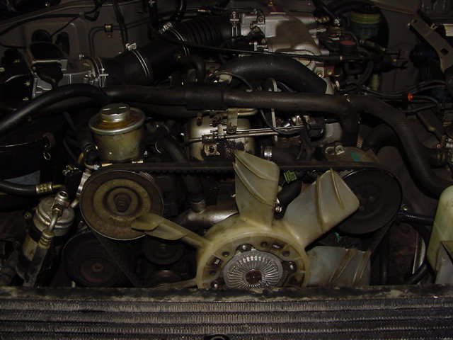

here's what it looked like after i removed the trans and t-case combo:
next i removed the flex plate, the transmission adapter housing, the trans dip stick, the cooler lines and the trans shifter assy.
i'm also replacing the oil pan gasket and rear main seal (always a good idea when the trans is out) so i pulled all the oil pan bolts and set up a bottle jack to slowly put pressure on the pan from one side in order for it to be removed without damaging it.
next i pulled the radiator, rad hoses, some of the heater hoses and the thermostat housing. this is not necessary for the conversion itself but the rad had a leaking top tank and the thermostat housing had a stripped bolt hole. i'll be replacing the lower half with a new unit. a new rad is being installed as well along with lots of new hoses. we're in this deep so we might as well do everything right.......

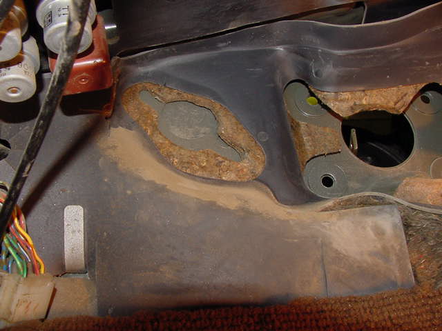

and a pic of the fire wall from inside the rig. you can clearly see the outline of the holes needed to install the clutch master cylinder.
i used a punch and hammer (my spring loaded punch retired just in time) to mark the center of the holes needing to be drilled and then drilled the two holes for the clutch master mounting studs. doing so under the dash was lots of fun. there's soooo much room to move around.:rolleyes:
i used a hole saw to cut the required hole for the clutch master push rod to go thru the firewall. after a little filing the holes were debburred and looked just like they were meant to be there.
