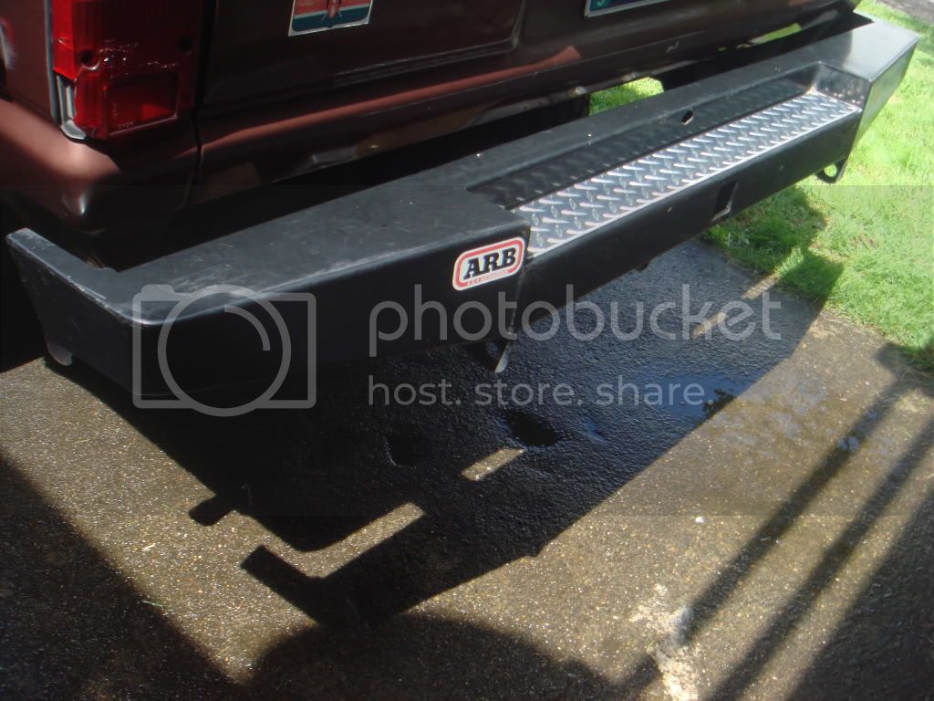

FJ62 Old ARB rear bumper installed
MJM,
Thanks for the info. The whole bit about the 3/4" gap between tailgate and bumper makes much more sense now. Agreed, the bumper isn't super beefy like some of the others out there, but I think it's strong enough for me. I would say it's similar in construction to my front old-style ARB bumper.
I like that I can actually lift the thing, and that it will minimally contribute to cruiser rear-end sag. It's way more stout than the stock bumper & bumperettes!
I suppose I could sell this bumper, but it matches my front ARB so well. Gots to keep the cruiser fashionably accessorized.
Any ideas of a similar rear bumper that is more FJ 60 specific?

I would say IPOR has a channel bumper that bolts up nice and tight to a 60 and is not out of line with $$.
Beyond that most are more than just a tough bumper. Your rear departure angle will suffer from the ARB but I have gone on some trails following a stock rear bumper 62 that would hang up when I would just drive by. I did need to drill a couple new holes in my frame to mount the ARB. Not a hard job that can be done by one person.

So I received the following email from ARB:
"You are very fortunate to have found this rear bar as there are not many around. We haven’t sold these in many years and only sold a handful a year when we did. Unfortunately the instructions are no longer available, however it should be a simple slide over the chassis rails and bolt on installation, using Grade 5 hardware. I did manage to find this old tech note which may or may not be relevant to your application.
Best Regards,
Nils Bull
ARB Tech"
With the attached "tech notes"
"ARB rear step bar for 60/62 series Land Cruiser
• Fits Cruiser with newer crossmember
• From 8/85 and up
• However some newer rigs have old cross-member
• If you have the older style C-channel, you can either cut out the rivets and move it forward 4” or replace with newer style x-member."
Moving the cross-member forward 4" seems like a bit much, especially if the gap is only 3/4" off as MJM said.

So I finally got around to adding some "traction" to the step on my bumper. Was going to get some skate deck grip tape or a stair tread traction sticker, but this piece of diamond plate was just lying in the scrap bin. A couple quick cuts with the shear (35"x3-3/8") a quick grind, some 3M foam double-stick tape, and voila. A bit shiny, but free...
