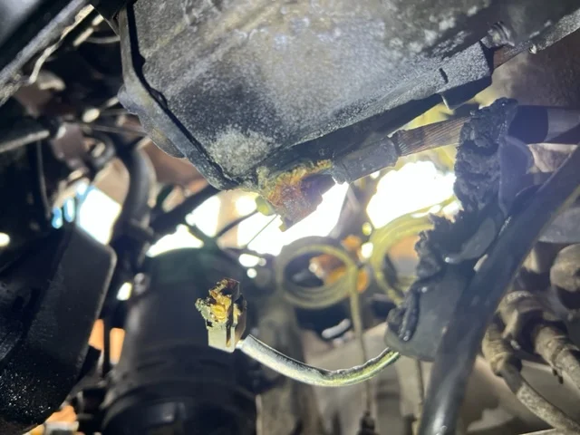

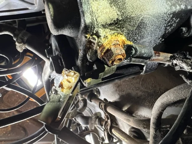

I'm gettin' ready to install a new starter on my 87 fj60. I had what looks like a short at the positive cable lug (very corroded - broke off when I tried to loosen nut. see pics) on the old starter which also fried up the plastic clip (male) for the ignition wire. I now need to replace wire and clip. I found what I think is the proper male connector online but will need to wire it. Thinking best approach is wire new clip with 4-5 inches of new wire, cut off roached clip and butt connect new clip/wire assembly to existing wire. I could try to attach new clip to existing wire but space is limited and awkward.
