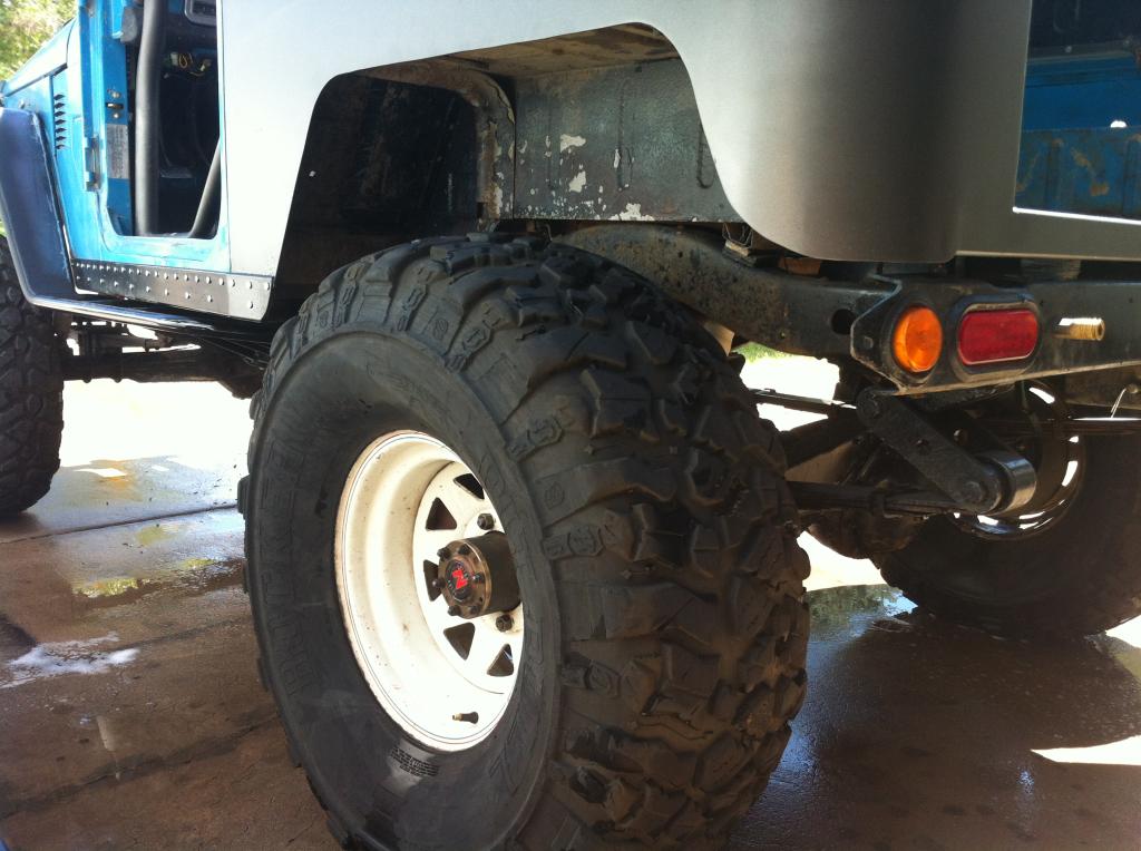

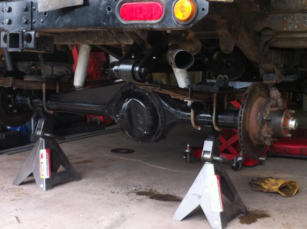

I'm currently running 60 rear springs flipped in the rear with 7" shackles in the stock mounts and 40 rear springs flipped in the front on 6" shackles with with the front shackle mount moved back ~2". Leaves me with a 22" frame height on 37" Pitbull Rockers, so it is pretty low over all. The shackles are about 40° so they are flat with about 5" up travel and 7" down in the front and more than that in the rear.
6" rear shackles and stock 60 springs
I apparently don't have any pictures of the front springs or of the springs after I started swapping leafs. Taking the short leafs out made for flatter springs so the 7" shackles were used to regain height.

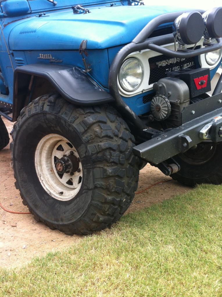

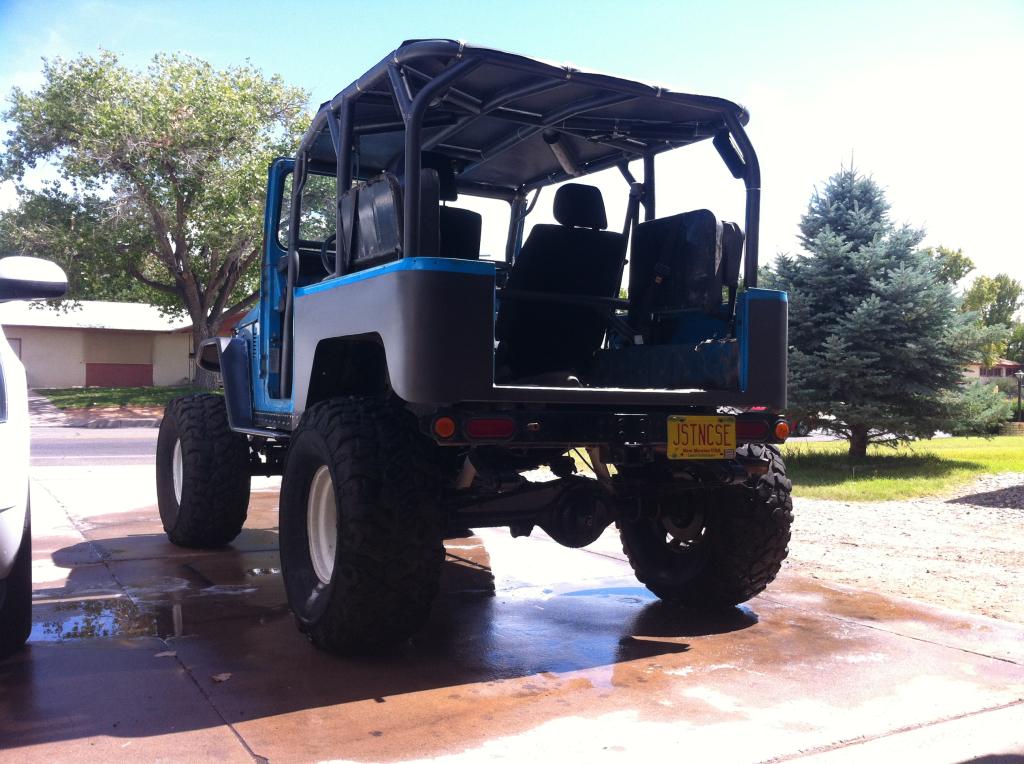

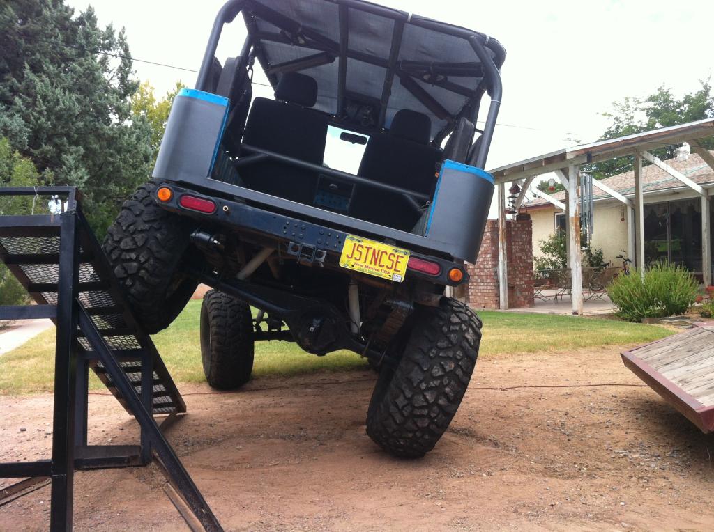

Jstncse - do you have a pic from the side to show general ride height. Sounds like your setup is pretty much spot on what I'm after. Any flex pics?
Thanks
I have a few,

A couple close ups after the fenders and quarters
