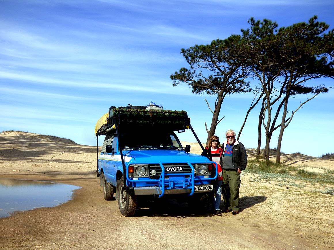

If it were me, I wouldn't bother with the rear axle for a long while. I've done enough on 33's and weight to not worry, nor have I read of any widespread rear axle breakage for wagons until they get built large and hammered on.
That blue 60 above has been all over the world with huge loads on it, and it runs semi-floaters with drums. Maybe if there was an easy way to get rear discs with a reliable e-brake, I'd do that. But there isn't.
Haven't seen a need for a high output alt either. The HZ has an 80A and has been ample with the hefty loads it gets.
I have been in touch with the Schmids for some time. They have been cruising for 28 years in the same rig with only one engine overhaul done last year. As I said a stock Land Cruiser will take you damn near anywhere you want to go. Just fix up what you have with some forge axles and lockers and you will put a Camel Trophy Rover to shame with a hell of a lot less money. As Paflytyer said above, a fridge freezer, Ham Radio, and also Long range fuel tank and water tanks with a good filtration on both the fuel and water. The FJ60 Axles are very strong. If you are dead set on an axle swap then you might as well be a grizzly and step up to DANA 60`s or even 70`s. Then again that would be way over kill. I would stick with the stock set up. Tires: You may want to jump up to 16" steel wheels. The 16" tire is more prevalent abroad. In addition you typically get a stronger side wall especially when aired down when crossing deserts. You can`t go much better than BFG 285/75R/ 16 Q AT`s or BFG 255/85R/16`sMT`s K2o`s. I would also invest in a good set of MUD Chains. Even the knurliest mud tire will get clogged up in thick mud. That is unless you have a 500HP Big Block Lurking under the hood to spin the mud off.
