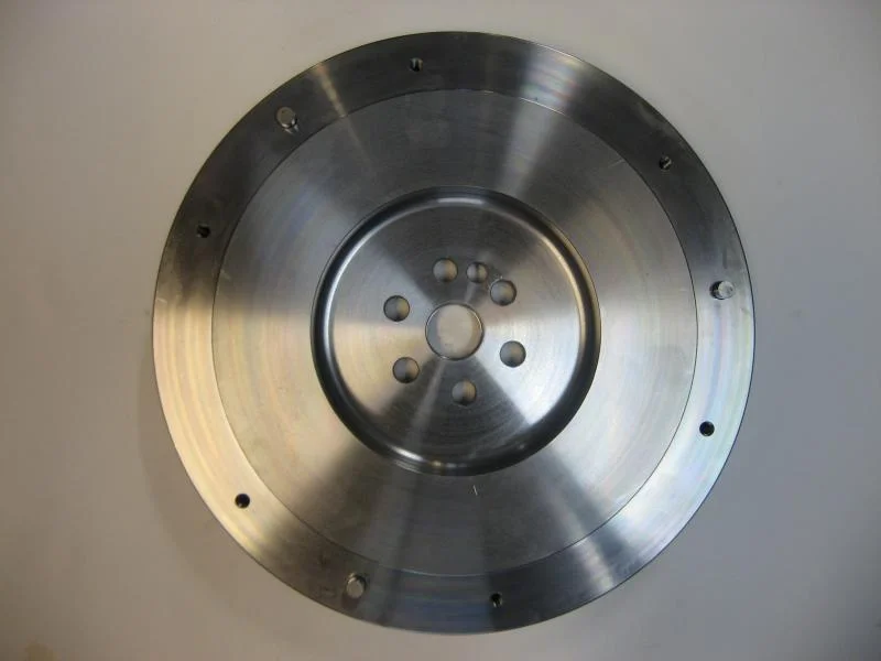

The Isuzus do not have a bellhousing pattern cast into the block, just bolts and dowel pins in the rear face of the block. From Isuzu the engines came with Isuzu specific and SAE bellhousing adapters.
A little proud of these, had to share! We made one extra.

Those look great. If I remember correctly, anything the H55 can bolt to will work with a later model H42 with the spacer. So, if someone wanted to do their diesel swap in stages, they could just swap in the H55 later on, after they got sick of the 4-speed/saved up the cash.
My understanding is all the late H42 bellhousings work with an H55 while the early bellhousings need a little clearance grinding to fit an H55, but are otherwise identical.
These adapters mean no custom clutch pieces, your tach works, no driveline modification.
Man those are stunning. Great craftsmanship and looks to be well executed. Wish something like this was available when I put my IDS kit together. Maybe I will start saving my pennies and ....
Well done sir, well done.
