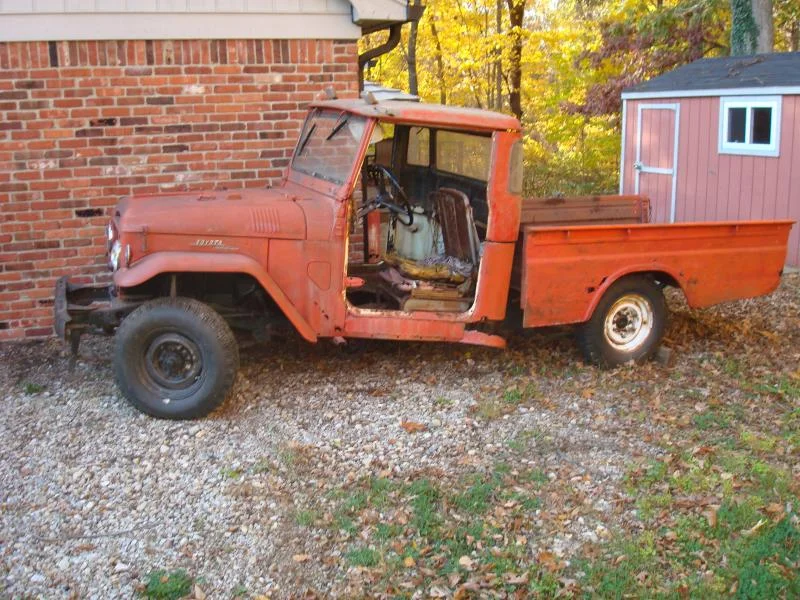

I recently purchased a FJ45 Long Bed Pick Up and am feverishly looking for a wrecked/rolled locked 80 as a building platform.

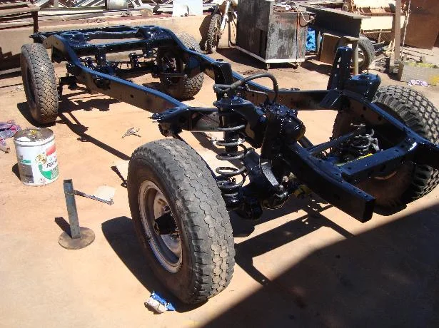

(If anybody has a pic of an 80 frame with axles and an engine trans and maybe steering components, please post one)

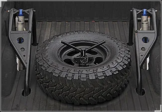

Ary, I was kind of thinking something like this with a slant back look. Maybe with a soft top over the roll bars/bed. Invert the tire to the inside, use a hinge at the back so it folds down to the tailgate. Keep the tire from hanging off the back and keep the weight inside the wheels and lower without taking up bed space. Since it will be limited with roll bar and coilovers.
Food for thought
coilover rear end....NOW we're talking. Did you use google sketchup to design?

With nothing in the way? Three link w/ panhard up front and triangulated four link rear. Coilovers of course.
Any designs that you've seen that I can take after?
