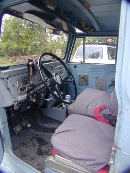

You know... when i got my HJ45, everyone kept telling me how i was not going to fit in it because i'm a big guy. 6'2" 270lbs... but i fit in the cab of mine just fine and my head isnt anywhere close to the roof of the cab. I even have quite a bit of room between my steering wheel & my big old fat belly! :deadhorse:
I went outside to see if i had any interior roof brackets that i could photo for you but none are there. Just the original creases that run front to back .

wooden brace, came installed in mine, works perfect
If I remember correctly it was a piece of oak with a section of about 3/8 x 2", cut too long to fit inside the rails above the doors. Since the cab tapers forwards all one needs to do is pound it towards the windshield with your fist and it bows upwards, holding the top up. And no need to repaint. Must have been some kinda hillbilly engineer to come up with that....:hillbilly:
one of my favorite PO mods.....:D
