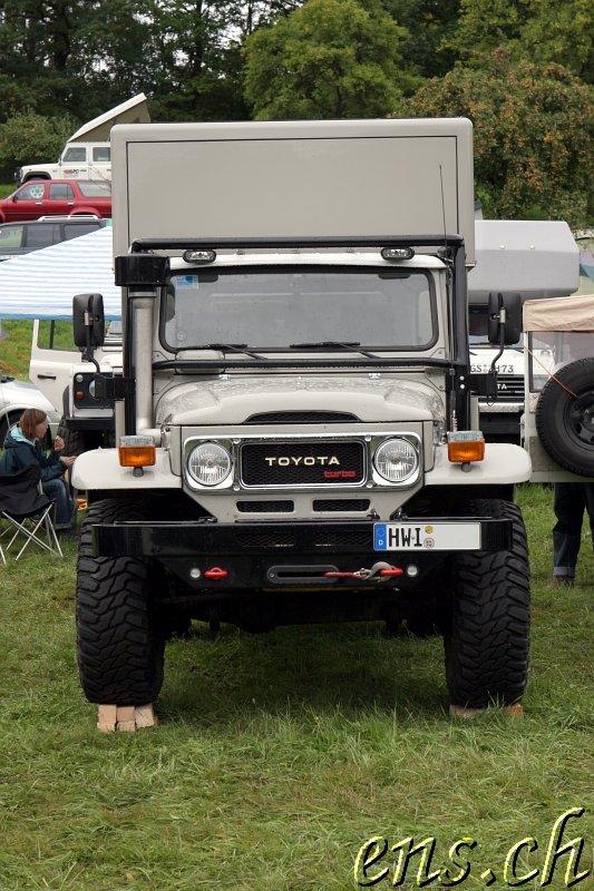

Soenke can you tell me if you cut up the 45 body to have it sit lower on the chassis like waggoner did to his? He said that it sits high up if you dont cut channels for the frame. Do you have stock height suspension? What size tires are you able to run?

no, why should I do that?
See the red hook, it goes in the front end of the frame, the part of the bumper above is equivalent a body lift.
Otherwise you will not fit the fenders over the tires or a radiator in front of the engine...
maybe you can arrange everything more beautifull further back and not so high, but we wanted to use the original Toyota parts in order to make maintenence easier
