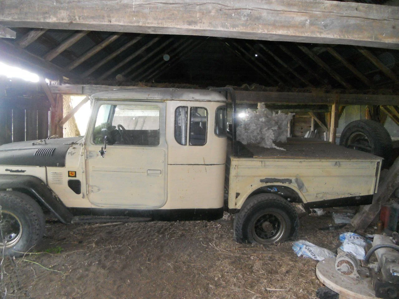

I pucrchased this FJ45 about 10 years ago and did a blaze on it one year then moved west to Calgary.
So this is how she looks today, I have plans... ok ... hopes of bringing it out and finishing some minor things on the truck and driving it this summer 2012.
The original plan was to do a frame off rebuild , blaze like hell and then found out I still had more shop time left so...
The dream of a king cab came and alot of sleepless nights and many disregarded drawings were thrown out but at last once done, time was still available to drop a B diesel in that I had laying around.
All photos were taken with the old school camera untill the end when I got a digital.
It was a regular cab with 2f and cracked frame when I got it. Now it has a B with a 5 speed welded and galvanized frame and reupholstered split bench seats. Suspension Correction kit and stock leafs & a pto.
Future plans are a turbo with propane injection , 33'' , emergency brake conversion and some headlights and looking to make a few RMLCA meetings and possibly trail runs.
No plans of going power steering , I want to complain about something for a while. lol

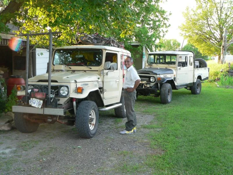

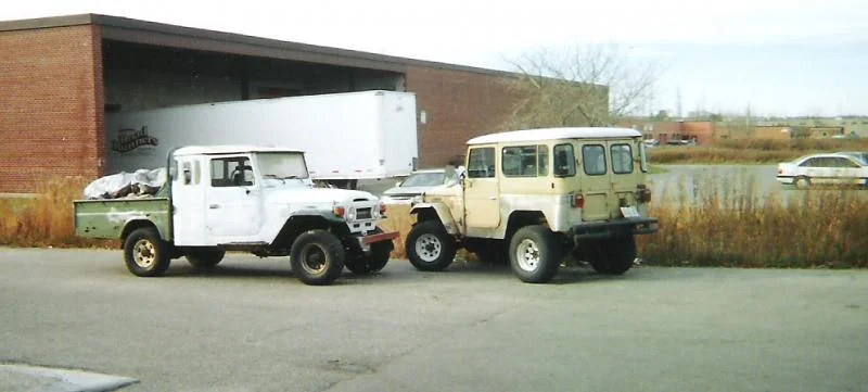

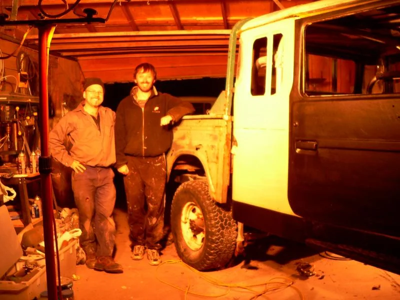

Posing is my niece and my friend with 42.
The bj42 is a partial stainless rear tub nerf and front bumper.

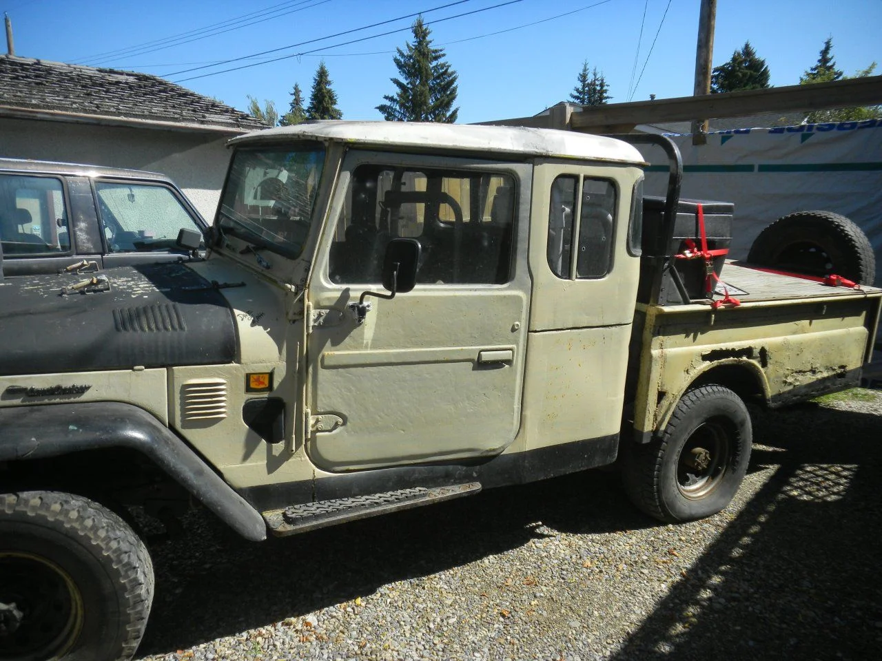

I had some parts like a roof laying around with side window panels. The length of cab is a personal choice as my friend wants one longer, it's what you think you need. I went with 17''.

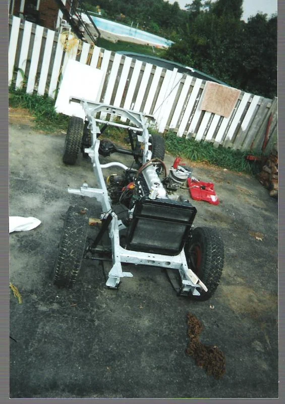

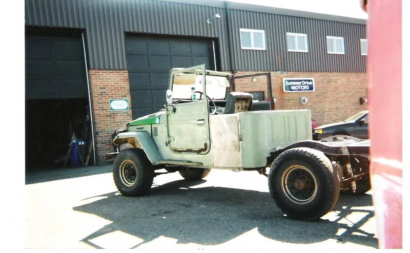

A brief cronology of events that started in 2003 to 2005 :
The truck I bought in 1995.
helped friend rebuild his fj45 and he game me a frame he had.
> I welded and repaired it adding a correction kit then we galvanized both frames.
> I drove Kanga ( fj45 ) in the shop after my friend closed for the day Fri. eve. pulled the frame out and slid the galvanized one under , so to speak, and at 8am drove the truck out of the shop.
I had drawings I'd been working on for a king cab but didnt know when I would do it.
> My friend gave me more shop time so I drove the truck in another Fri. eve. pulled the 2f out and droped in a B and 5 speed I had sitting around and drove it out after pulling another all-nighter.
Then again Remi my friend with garage once again extended the offer and I started working on the king cab.
> This was not a one nighter but many many many evenings, weekends, and some days before the king cab would be complete.

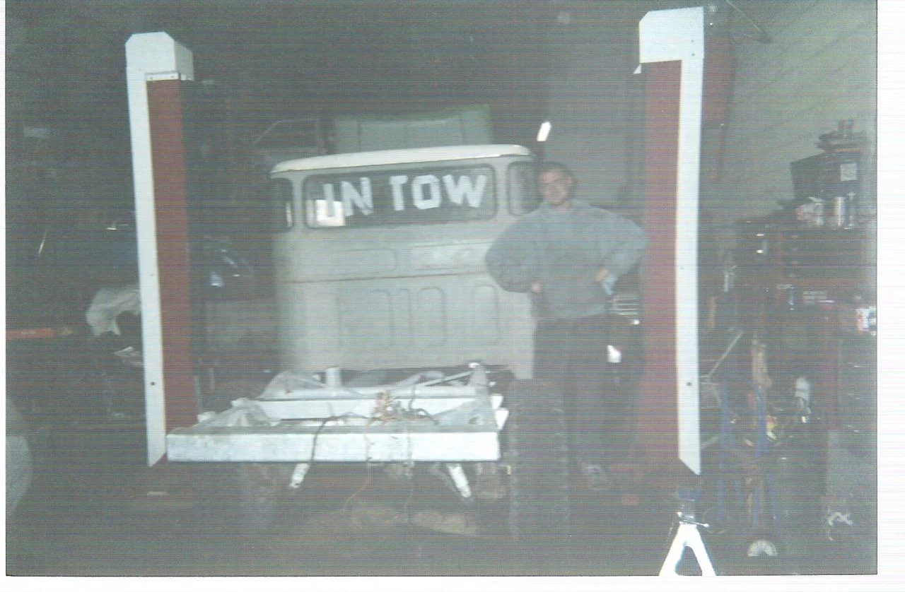

Just a few more shots of the build up construction.
A work party commenced at a friends place and other friends stoped by to help out. ( yellow )
The yellow was then changed to rocker gard beige and black.
2013 The truck will likely become just beige and get street legal.

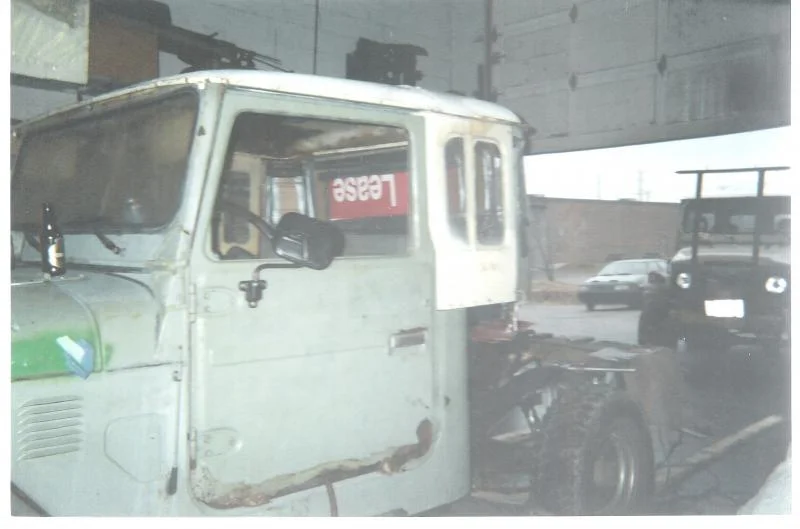

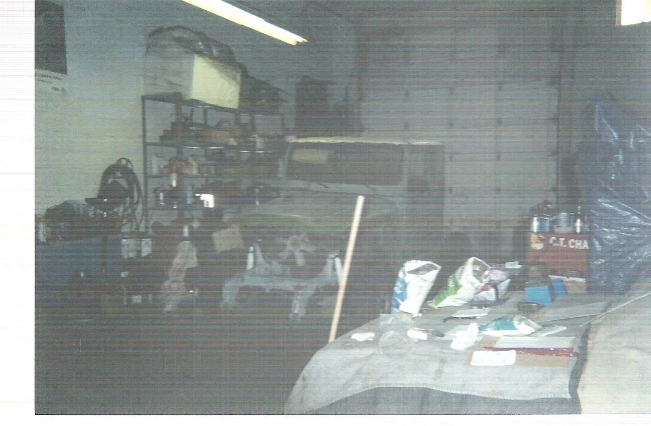

a few more pics of the king cab process and frame off and on process with old retro disposable camera.

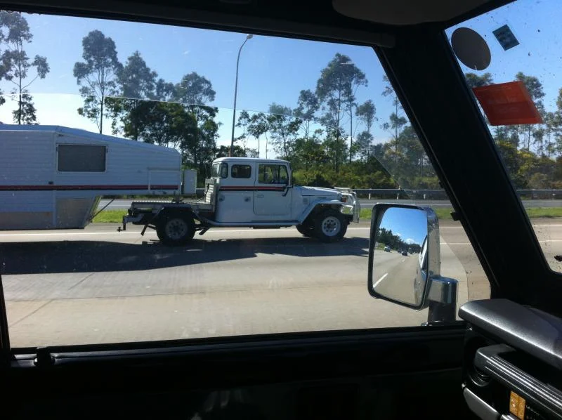

Saw this heading down the Gold Coast yesterday. Prob a 40 lid.
That's a cool truck John!
I saw one on the road the other day (passed it quickly, didn't see it well), had a large box, or small camper on the back. Yours?
Not mine ! too many projects now. You need to get more photos in your garage ! especially of your new addition ! for all us Cruiser porn addicts !!

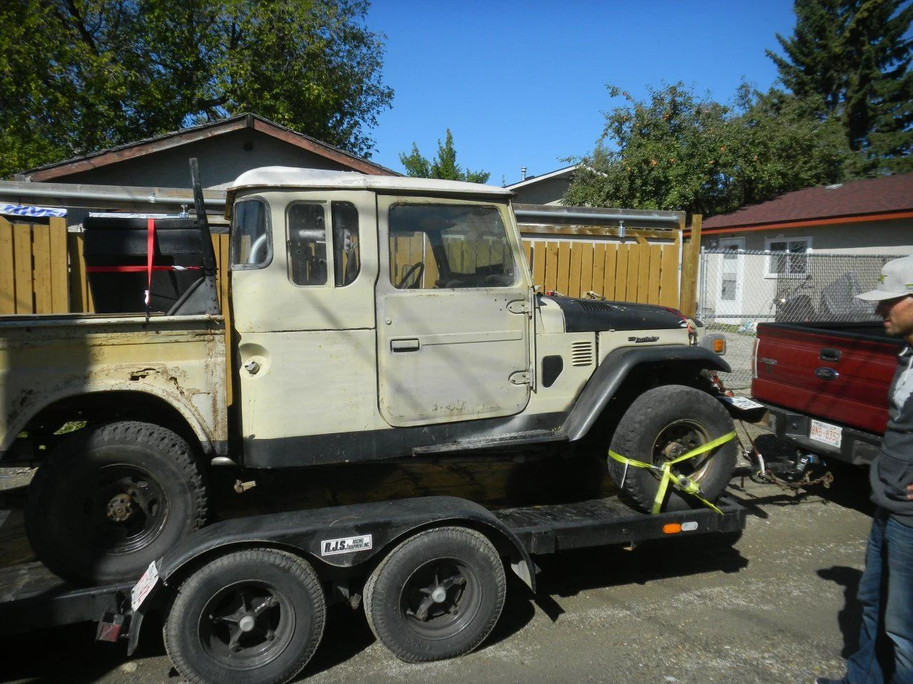

Well the Magical Day has come to ship the fj45 west to the land of sun and fun !
I had found a shipper through Uship.com where I put my details in and then received bids to haul my truck ( non-working e-brake ) to my home in the west !
I received many bids and this guy was the best price and his ratings were very good, he has kept me in the loop as to since he picked it up. I used Uship.com and Aaron (Acbarr1) won the bid. Excellent service and timely delivery.

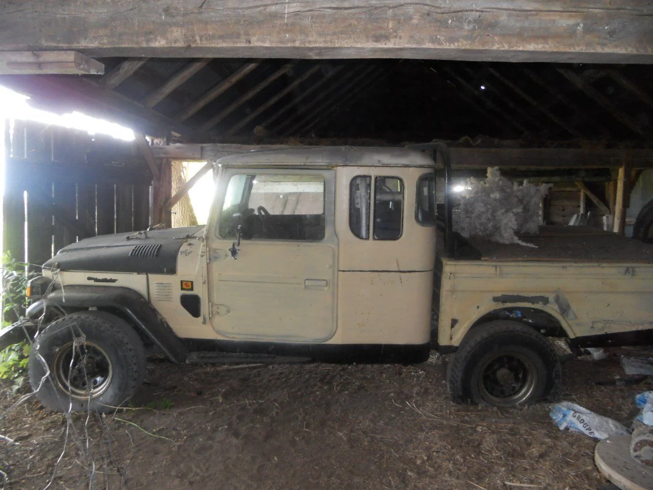

Once I get her home then it's the final 5% of finishing work to be done though after sitting since 2006 there may be some other issues I may need to deal with.
I'm guessing there arn't any lenient out of province guys around are there ? ( pm me if you know someone ) this one's a keeper, it will be used seasonally and eventually get a new suspension in time along with some improvements where cash will be found !
I'll post up some new Aug.2015 photos when she arrives !
Well she's in after 9yrs of waiting. Now I gues the final 5 % to complete has likly changed to 20%. she's looking alittle rough. The delivery was on time as stated with excellent service.
