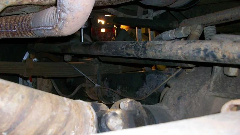

3 pics of mine, just took them...
8" stroke ram from West Texas OffRoad...hoses from Fleet Farm....welded tabs to the tie rod, welded upper tab to the axle housing and welded lower tab to the diff....
works.
Right on woody. What about the TR. If you need to adjsut it, with the ram rod welded to it, would you have to cut it off and reweld?
yep - set it up right the first time :)
that tie rod is the original one from 2004...so is the diff and the tab that's welded on there...the housing has been replaced and I removed/reused the upper triangular mount.
Thanks Woody!
I never though about welding the bottom tab to the 3rd member. Great idea and you can still remove the 3rd. Solves my problem.
