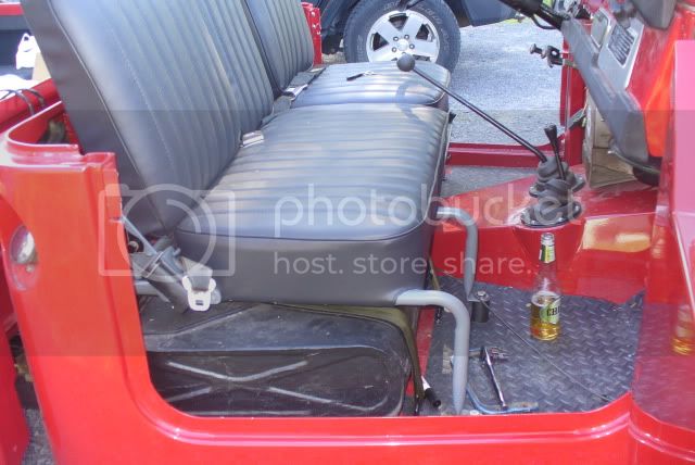

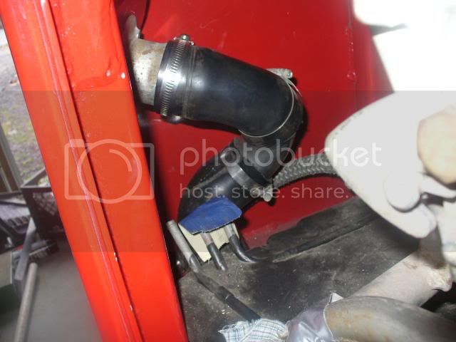

Thanks everyone, my 45 is missing a lot and trying to piece it together. Dont have a stock tank but have a 40 tank I was going to try. If you would please post the pix of the 40 tank and seat in the 45 and any real mods you had to do to get it to fit..
Before :
Fuel tank.
Is that a original steel cab? Curious I don't believe my tank sits that far back. It would be close to the front legs like in a FJ40. The difference in the tank isn't that great and where your is located wouldn't work with just the stock filler hose. As for the back legs I believe you could just extend the back out to fit on the raised section in the back like the stock FJ45LP-B.
Did the FJ40 get a bench seat in Canada in 76? Here in the US starting with the 73 model we got bucket seats and with the bucket seats came a change in the fuel tank. One of the major changes was in the fuel neck. The pre 73 was pretty close to the FJ45 tank. 71 and 72 had extra emission fitting on the tank. 70 and early only had the fill neck and vent tube next to it on the top.
I will check for the years (as i'm not sure) . Will see on SOR what years is my seat cauz it came on a fj40 1976 but the seat was modified .
I have only seen that seat in 71s and 72s. In 73 with the bucket seats the emission tank that was in the center section moved to the right side of the tub by the fuel fill neck. I have seen the back cab of FJ45 from Australia that was formed to fit the tank against the back of the cab.
Thanks a lot.. I can make that work, just wanted to make sure before I bought the seats..
