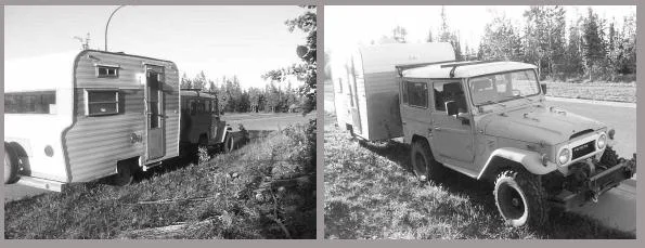

That is about the length of my tent trailer. It looks like you are running about 33" tyres, have you always towed on this type. I think they would be a little soft and might sway with a load on them.
Check out the book "Who Needs a Road". The guys in the book towed a tent trailer around the world...pretty amazing testimony to the ruggedness of our FJ40s.
they're actually 31's (bias swamper TSL) the trailer is a 1969, the truck is a 75, and they are almost the same size, there's sway lots of places:D
we keep it pretty local, and we aren't in a high speed motorway kinda place.
I think that I might have to raise the trailer some more or drop the hitch so that there is more tongue weight, and it would be a lot nicer to tow. also it currently doesn't have brakes, but when I had the new axle built I got it set up for them, so I just have to buy and bolt on, still not sure whether to go with a surge or pedal controlled type of setup.
