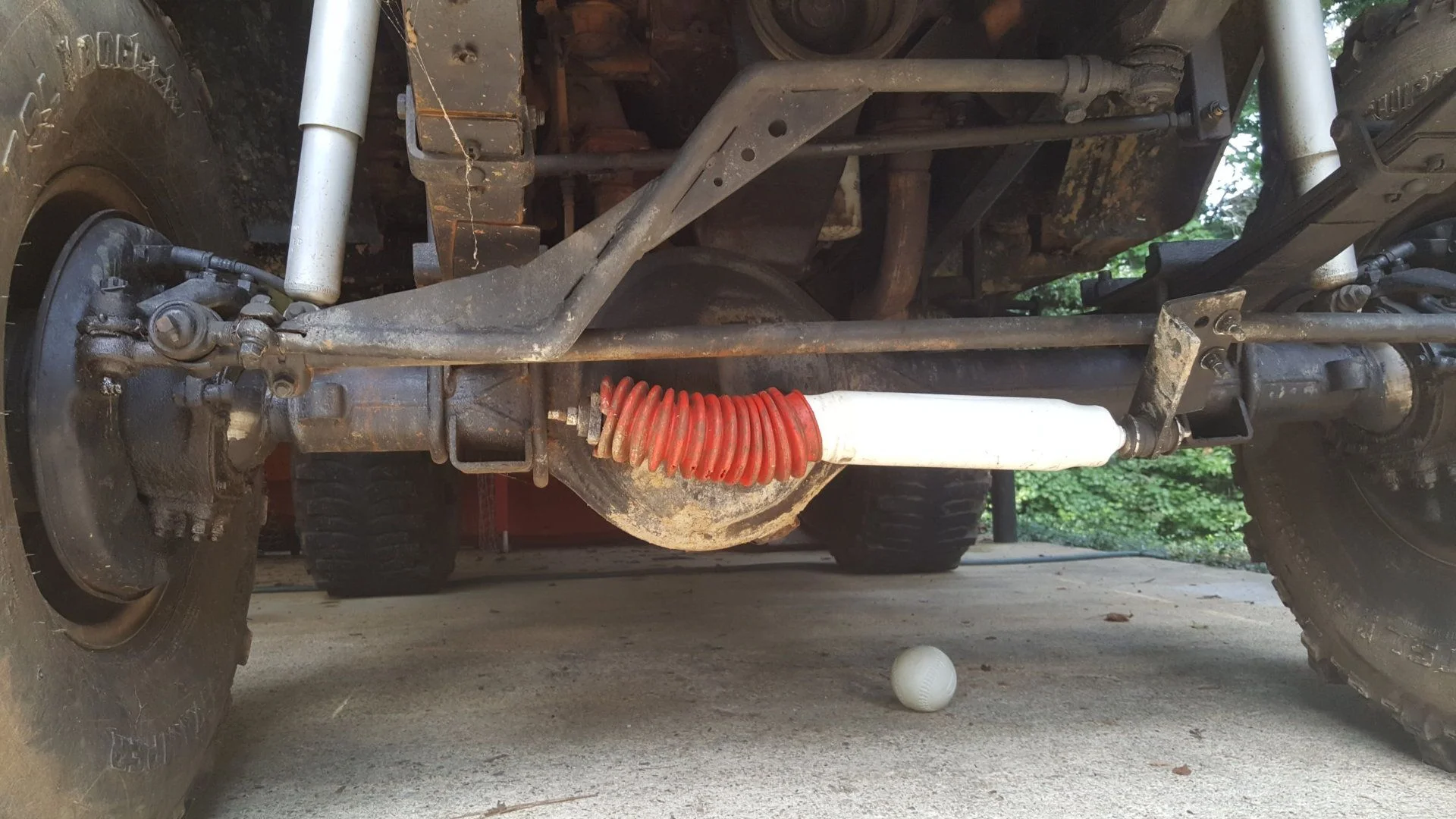

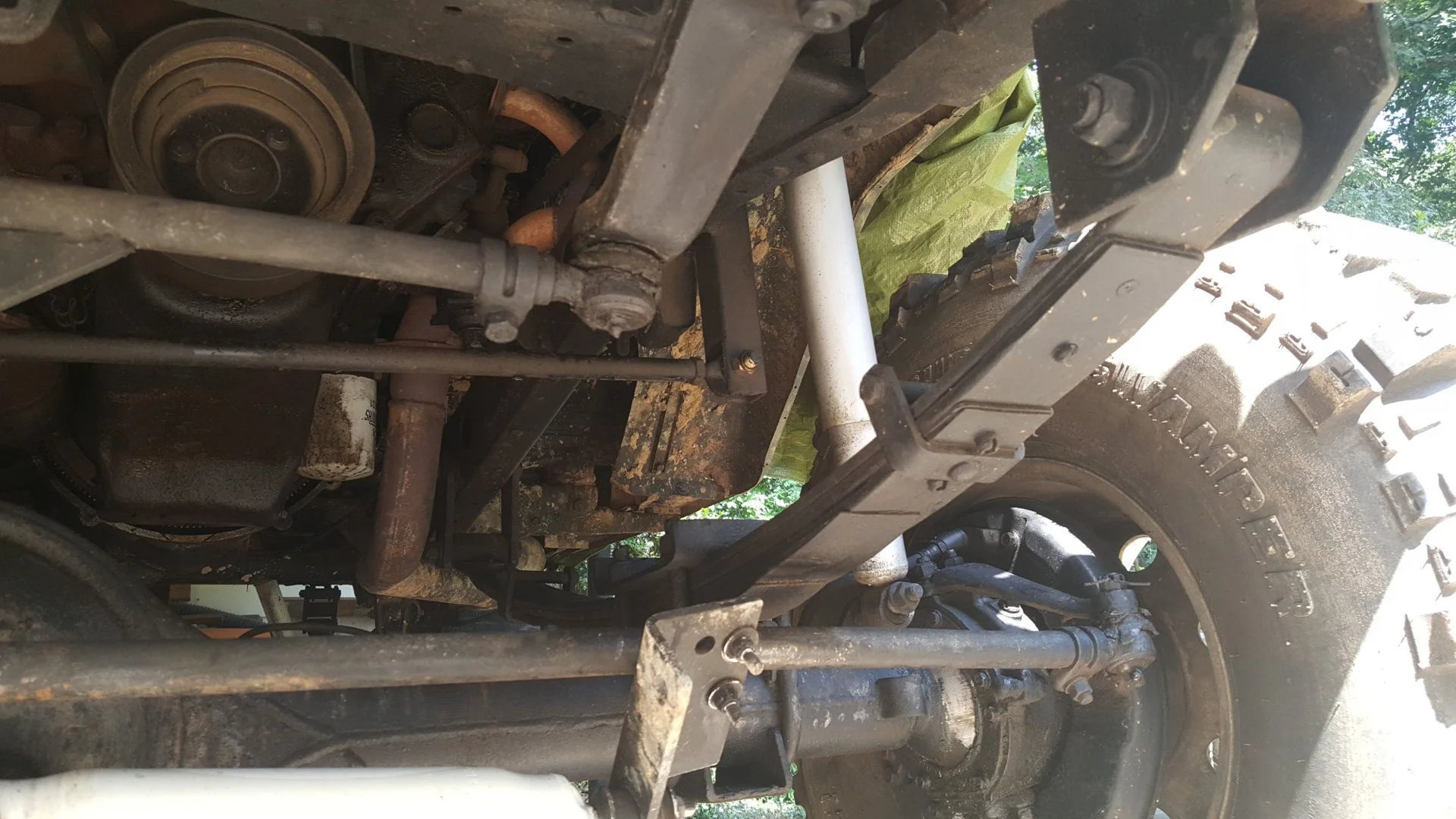

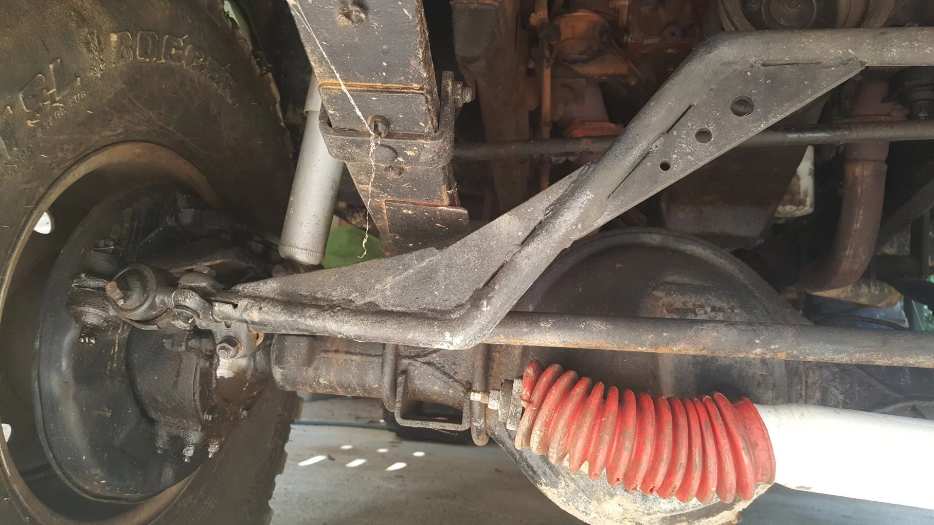

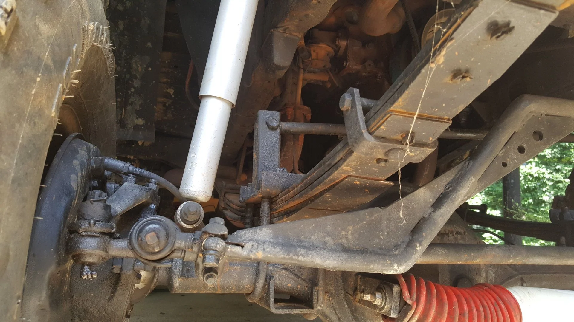

I picked up this '74 beast and am hoping to take it on the road soon. First off I need to get it down to a reasonable height and put some reasonable wheels and tires on it.
Here are some photos of the suspension. What all is involved in lowering it?

Jynx is a much nicer guy so he wont say it but WHOA!!! - That steering mock-up... :eek: somebody been doin' some booty-fabbin. sorry, no disrespect intended, you didn't do it.
As usual he's on the mark, spring-under the axle, shocks and tie rod will go a long way to get you where you want to be. After that you're very likely find more things to repair/modify but ya gotta start some-wheres.
Oh yea. You will have to replace the shocks, the rear shocks may have some alternate locations...top of ubolt plate, or on bottom... or you could go with a ubolt inversion kit.
Oh @TeddyBoy I'm with you on the steering. That is awful that folks think it is ok to Z bend those... At least they did reinforce the bends, I think...
@3pits got you a good list started. May need to flip or get new spring pins. Ted can help you there :p

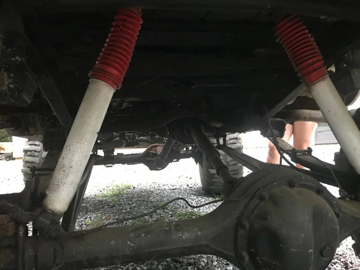

Agree, good list and/or summary comments made already and while you posted some great pictures, this thread begs for several more. First, just "have" to see a shot of the whole rig, just to confirm what all you're dealing with - ok I'm just curious. Seriously thought, need to see the front side of the rear axle to see what all is going to be involved with cutting off those ladder/wrap bars, the drive side rear spring plate looks like it's tweaked down and may not be reusable when you go back to SUA (the shock pin angle is interesting), need to see how tall front spring perches are (sorta look ok in picture but not sure), etc.
Alternatively - while you seem to want to go lower, a SOA with flat springs isn't a bad thing, but a lot of what's been said above by the others still stands - and high steer arms would be a must.
