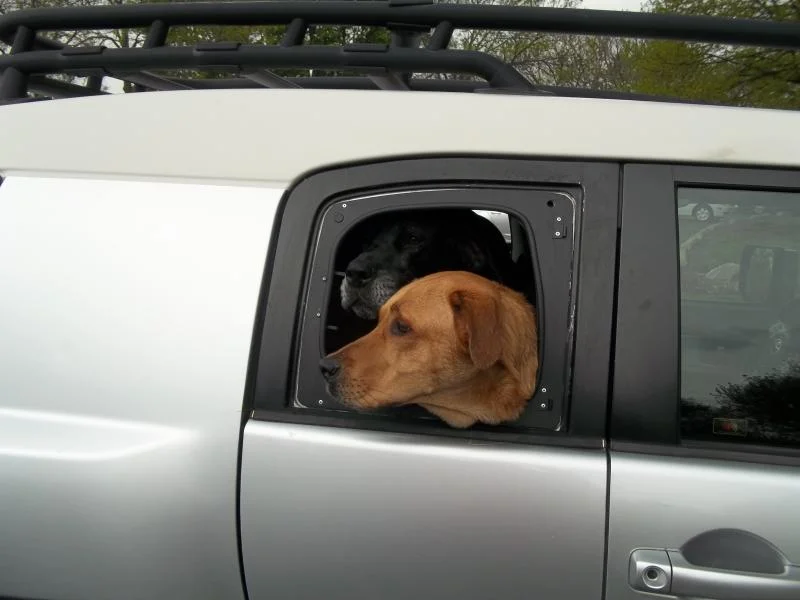

Just got back from the dog park. The first time driving with the windows out and the first time with the dogs in the truck with the windows out.
Worth every penny. The dogs love it. The wife bought the truck for the dogs and it was just a cave back there. The shepard would lean on my shoulder and I'd be covered in drool.
Now they just hang their heads out.
