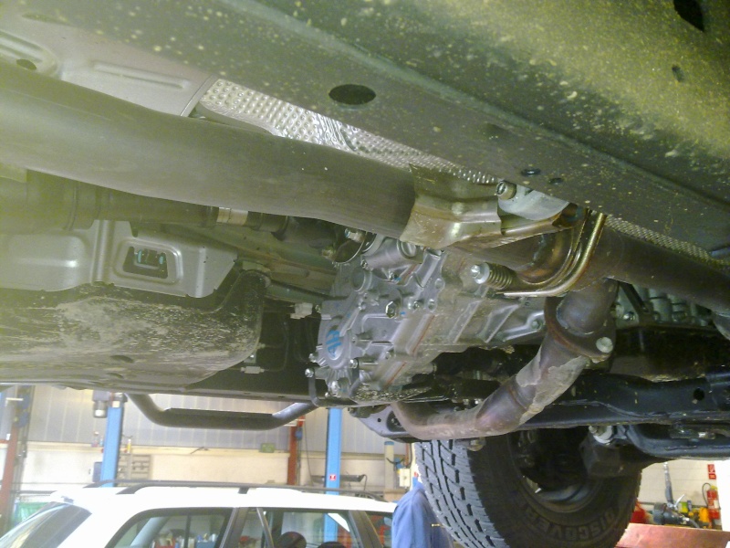

This WE I did my 5.000 miles inspection and at the same time I looked the first time a bit exactlier under my rig.
I saw:
- A great place for installing a second gastank at the rearside
- A very, hmm, strange exhaust system :rolleyes:.
Well I think, if I'm going rockclimbing the exhaust system has a short life under the gearbox :rolleyes:. The muddy or sandy grounds that I took till today did not had any impact at the exhaust.
What can I do? Aftermarket exhaust systems do they take the same way to join the Y piece?
Or do I better have to mount a protection plate?

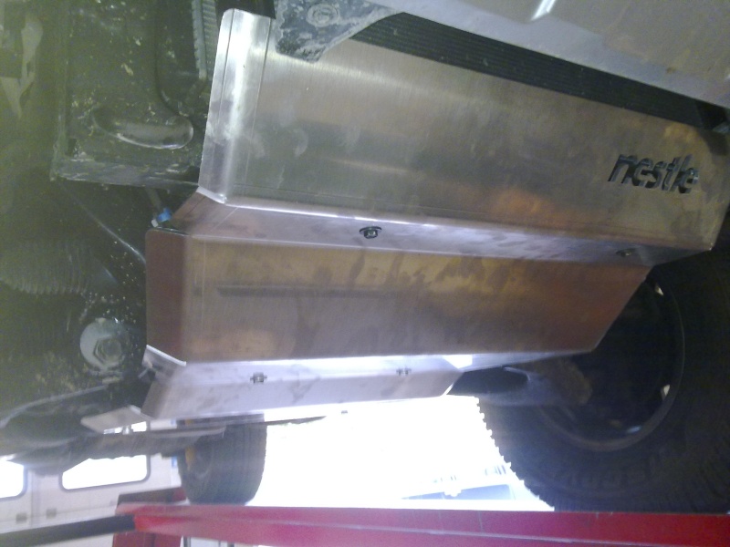

I did install a front skid place after removing the original protections
i noticed the same thing with the exhaust. unfortunatly aftermarket exhaust kits wont do any good because they all come after the joining point. the best thing is just have a couple new pipes from the back of the cats made so that they hug around the transfercase rather than go under it... would also get rid of that horrid crimping on the pipe from factory. the main thing with the factory design is so that heat from the pipe isn't too close to the fuel tank. i'm sure Toyota saw it was more cost effective to design it the way it is rather than put in extra effert to design a simple heat shield for the area of the pipe that would be near the corner of the fuel tank.

Toyota did install a heat protection at the right side so why not for protecting the gas tank :rolleyes: Ok ok there are a few lines at the left, maybe they saw too much problems there.
Hmm, :hhmm: I think that the easyest way ist to install also a skid plate at that place.

Yes, the best solution is a set of Budbuilt skids. Bud designed them to protect the crossover pipe and fit on a stock rig.

I think I can have this plate at the same place where I bought my front skid plate.
