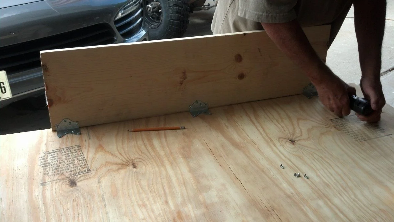

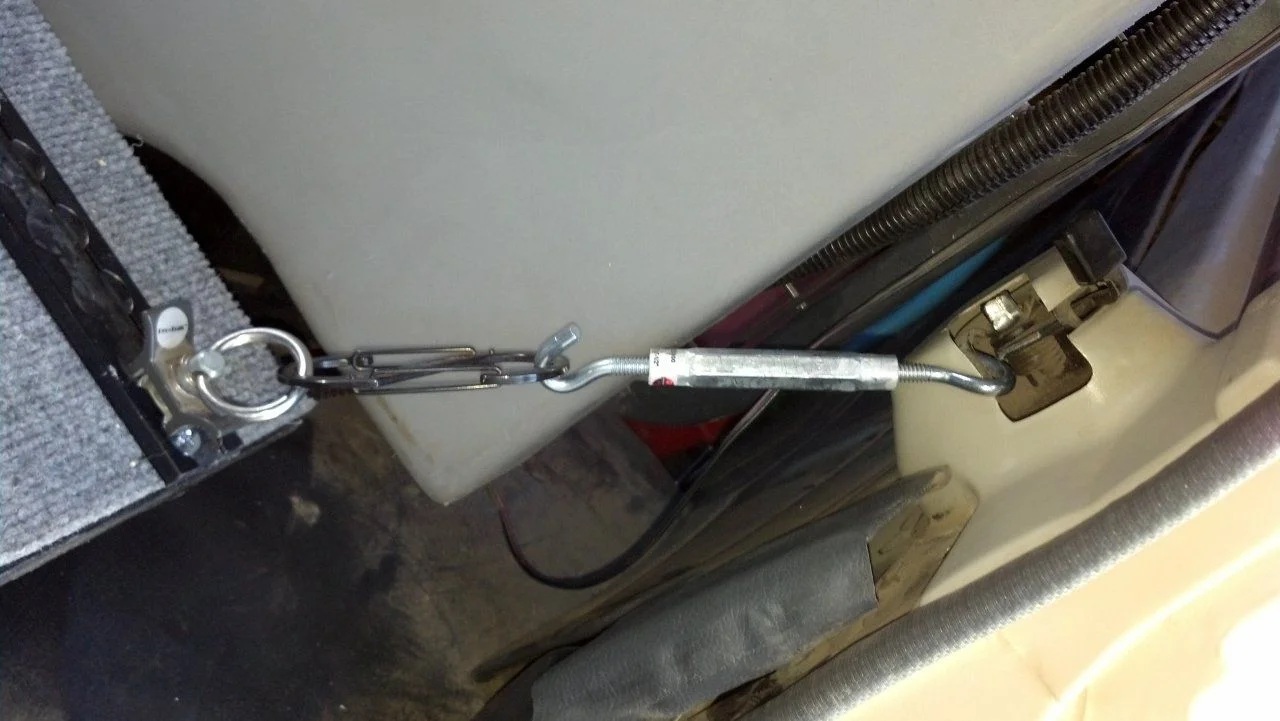

I finally got fed up with all the stuff I would put behind the front seats piling up due to the uneven floor. So I am building a platform that will solve that problem and increase the amount of stuff I can bring with me and better organize.

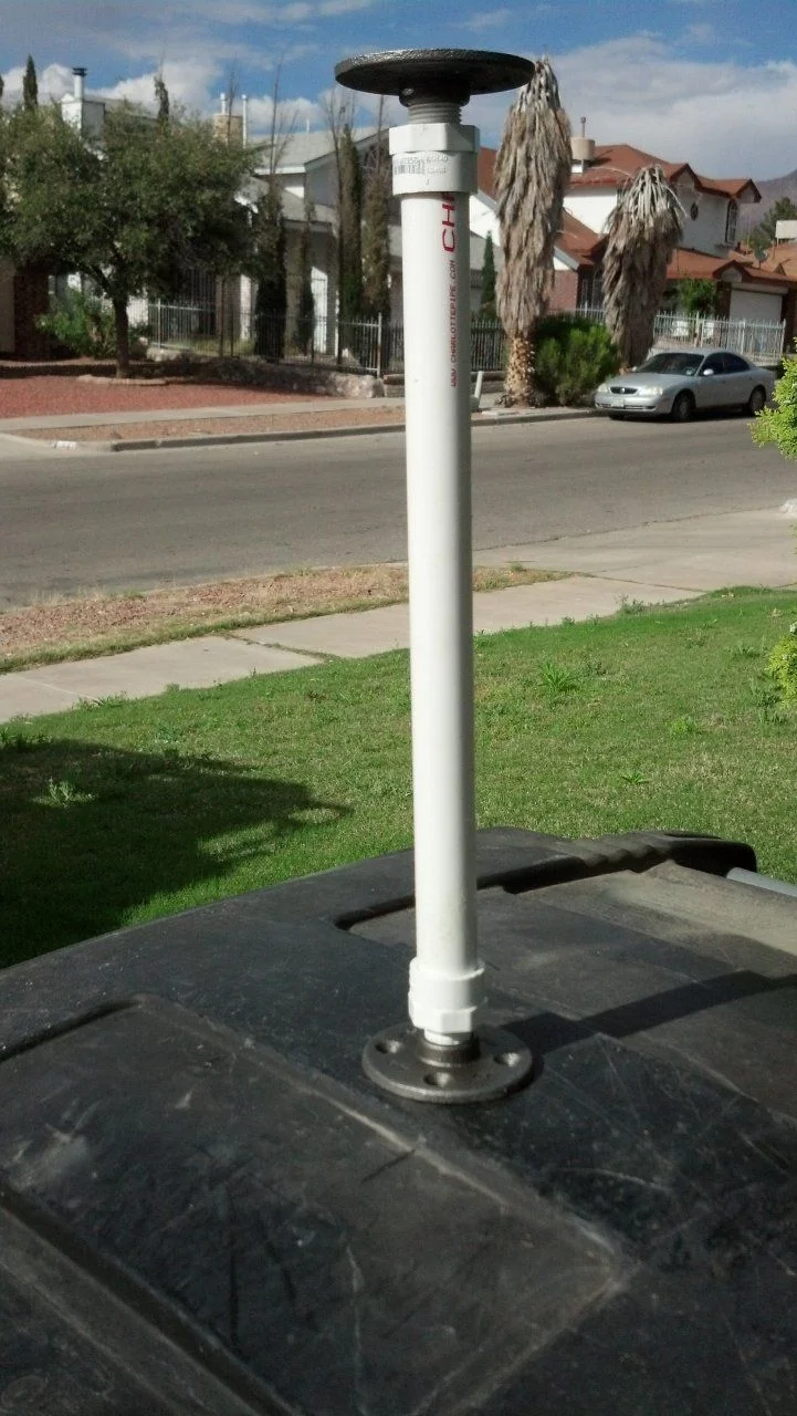

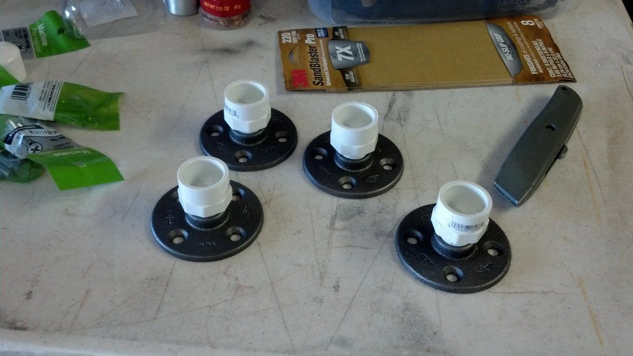

This is where I got to today. Tomorrow Get the platform level and figure where mount the support legs.

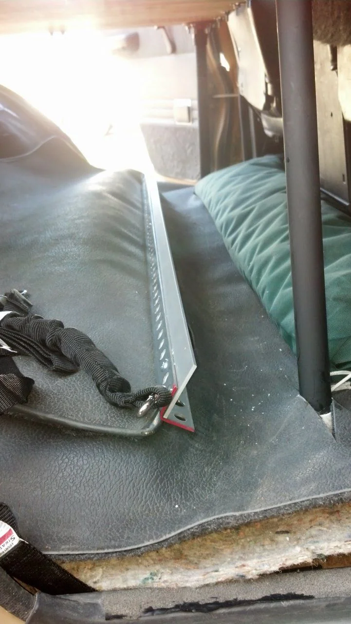

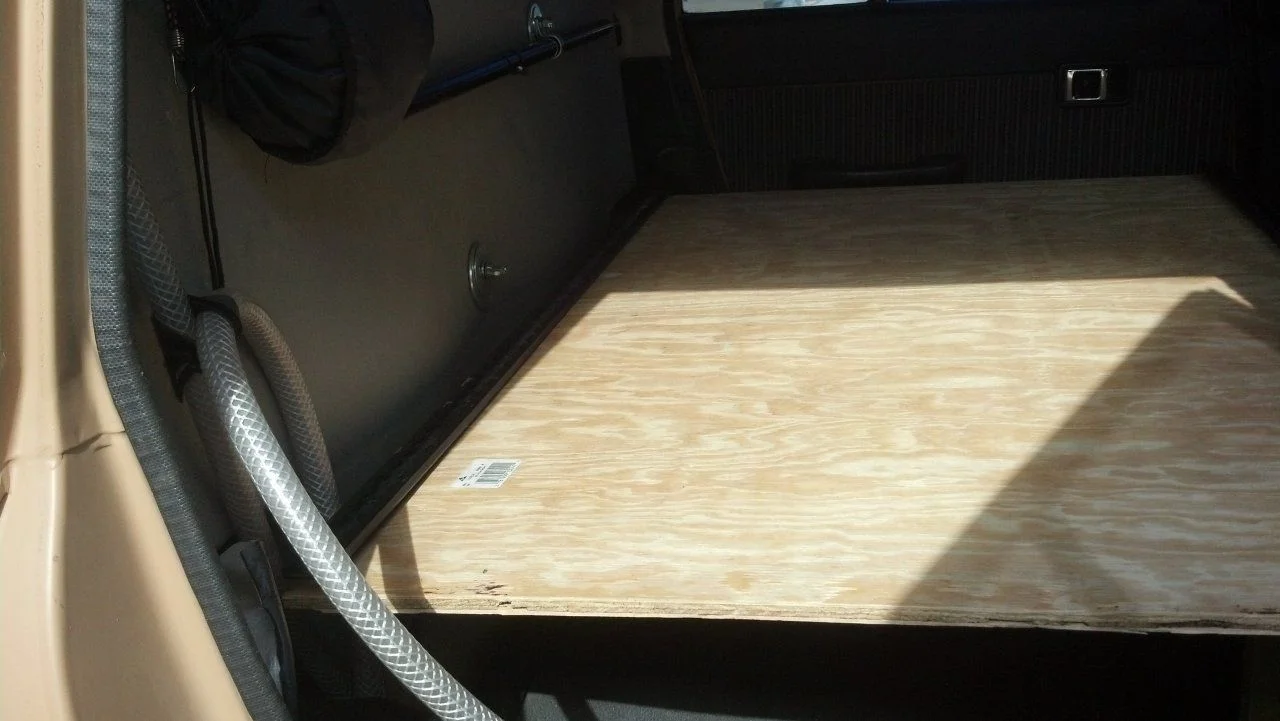

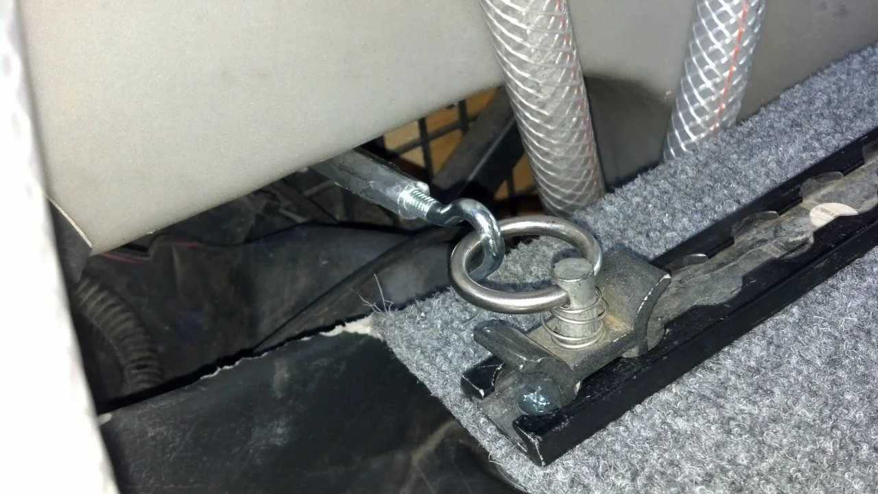

I finished up the project. I added a couple of turnbuckles at the back of the platform to add some rigidity as the rear is not bolted to the floor. also used the rear seat mounting bolts to run a piece of angle iron to keep any items from sliding to the front seats.
